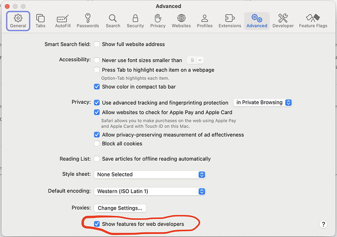

Could you please open Safari settings, then select Show features for web developers checkbox?
Once that setting is on, select Developer - Show Javascript console from the Safari menu, open the Dashboards page again (or refresh it if it's open), and click on the Edit device list button. Send me whatever error pops up in the console, including the full stack trace details. I'm near 100% certain there will be an error.
