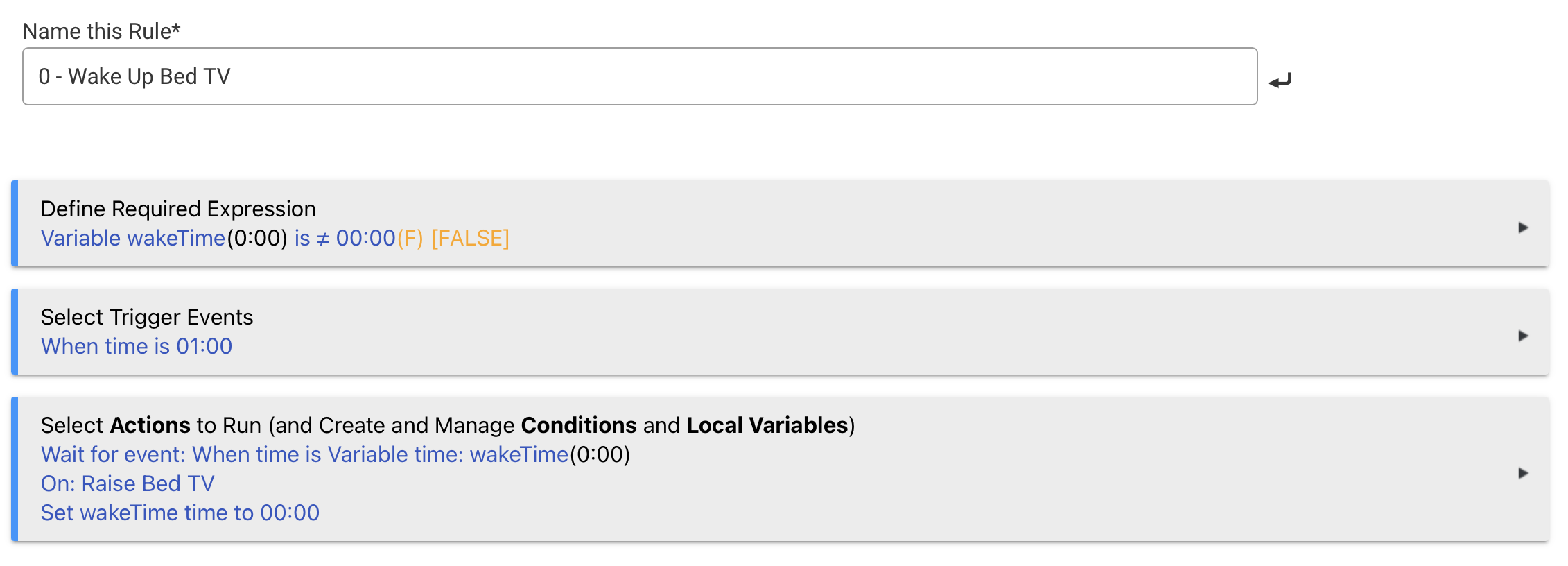

Thanks again. I got the first part of my TV Bed Wake Up working so just need to get a Broadlink ordered and possibly a power monitoring outlet.
I've set up the following rule and it works great. Tapping the variable connector on one of my HD+ dashboard brings up the time selection wheels and I set the wake up time. At 1 AM my rule is triggered only if the variable time is not midnight. The rule waits until the variable time and lifts the bed TV, then importantly sets variable time back to midnight, ensuring that the rule will only trigger if I set a wake up time on the dashboard before going to bed each night.
