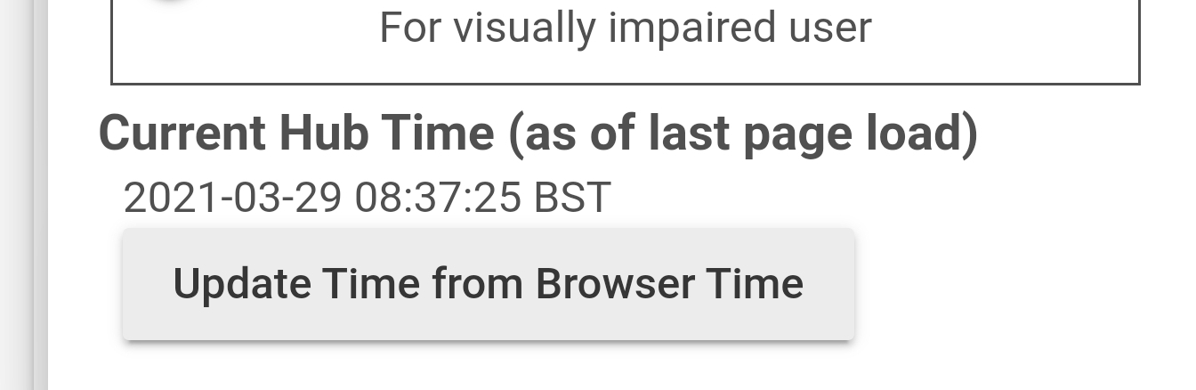

Since daylight saving yesterday, the time for my hubitat is incorrect.
I have time set to GMT,
I have my location set via X and Y
If I manually press update time via Web it updates to the new (+1) time. But if the hub reboots or goes past midnight it resets to pre savings time.

Ok so i was originally messing around with time zone, time itself (update from browser) and it still would not persist through a reboot.
I updated my location to include a post code (previously used X and Y only, no postcode) and now all is fine.
Not sure if considered bug or not, but with no postcode filled out irregardless of browser time or location based on coordiantes alone does not deal with daylight savings changes.
