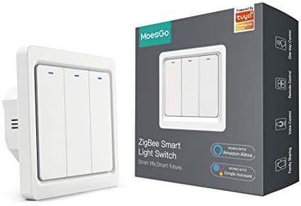

This is what you want?
There are these yagusmart ones that others have had working I believe:
Also, these Tuya ones ought to work:
