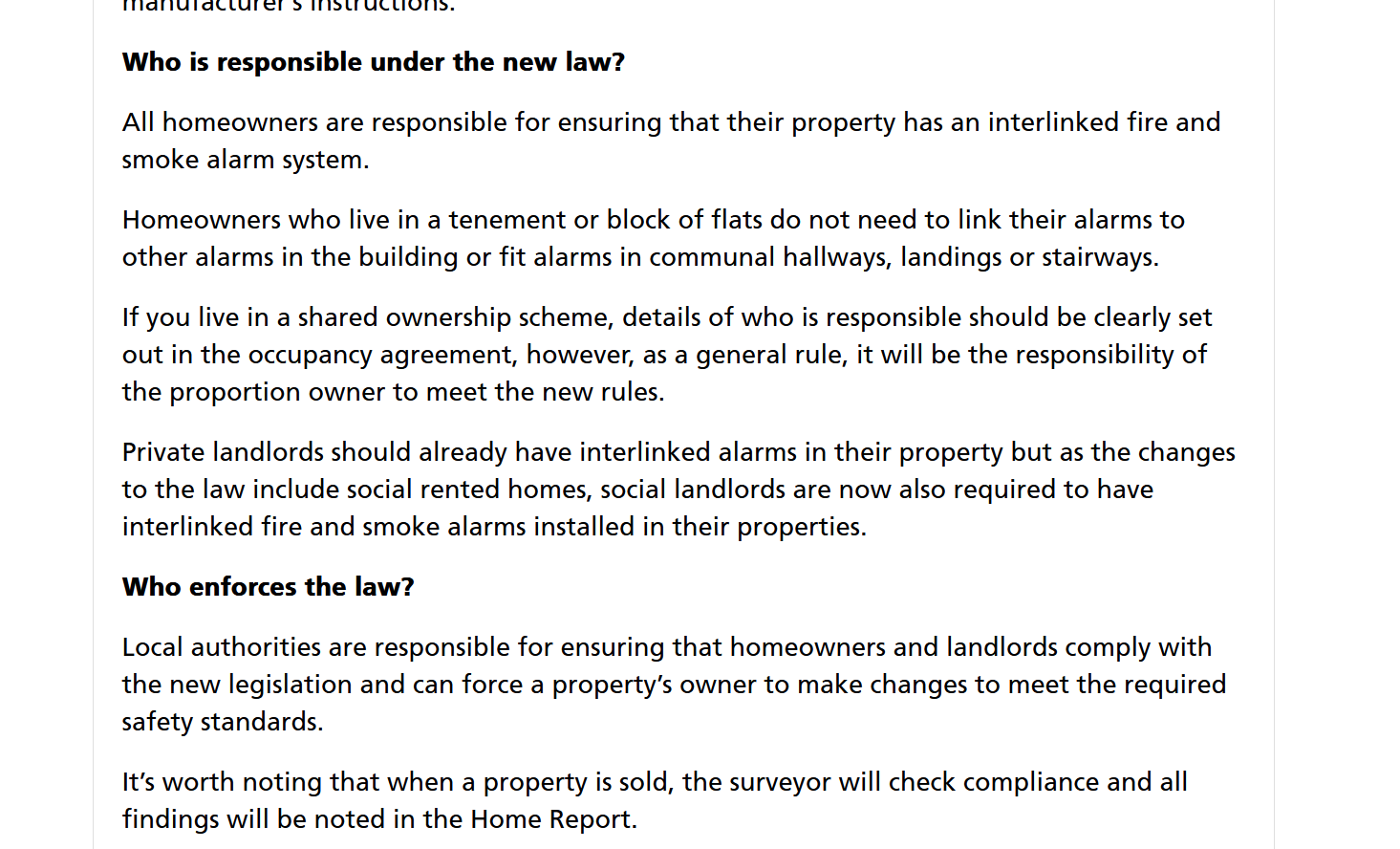

I've just had a look at the requirements and it's not as bad as it seems;
  • Smoke alarm in the most used room
  • Smoke alarm in every hallway and landing
  • Heat alarm in the Kitchen
  • CO alarm in any room with a fuel burning appliance
  • All smoke and heat have to be interlinked (not required for CO)
Importantly though they can be mains powered or battery (so long as the battery is sealed in/non replaceable type) and the interlinking can be wireless.
