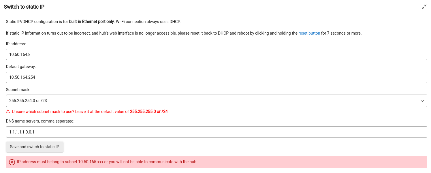

My Computer from which I am connecting to the C8 hub has an IP address 10.50.164.198.
The C8 currently has a DHCP adress of 10.50.165.163
The Subnet is 10.50.164.0/23 (10.50.164.0-10.50.165.255)
But I cannot change to static IP because some programmer effed up the IP logic... At least give us a 'change anyway' option already!
Anyone have any ideas?
http://<hubIP>/hub/advanced/switchToStaticIp?address=<staticIP>&netmask=<netMask>&gateway=<gatewayIP>&nameserver=<dnsIP>&override=yes

Yeah thats for a sure a bug, with that gateway and netmask you have an IP range of 10.0.0.1 - 10.0.3.254
Apparently it is just going to the highest /24 range and thinking you need to be in there.
You would have to use the endpoint listed above to force it in there. Somewhere in another thread I posted an example of how to build the query string for that endpoint...

Thanks, that works. Still stupid that they do now include a subnet dropdown in the UI, but can't get the logic straight!
