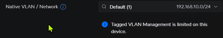

Biggest limitation is the Flex Minis have limited support for tagged VLANs (can only set one per port) and do not support STP.

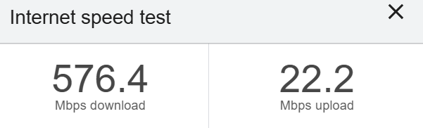

Even w/my measly slow internet connection and lack of high-end Unifi gear, things work pretty well...test on Wi-Fi.
