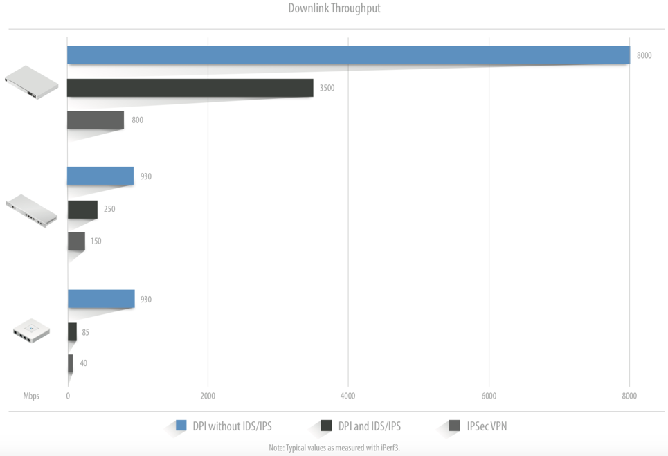

I wouldn't buy a USG with the UXG out in early access. The USG is dated and almost EOL at this point. If your internet connection is any higher than 250mbps or has the potential to be throughout the lifespam of the deployment, you'll find yourself limited by the older hardware.

I'm assuming without IPS enabled since the hardware of the USG simply doesn't support gigabit with IPS enabled. Actually it doesn't quite support gigabit with just DPI enabled although the speed hit from that would be negligible.
But is it really a SECURITY gateway without the security features enabled? The UXG will support gigabit speeds with all security features enabled. And the UDMP does. This is why I'd never consider a USG at this stage. It was the top in its day, but its day has passed.
Yeah that was probably my wide open test. I purchased a year or two ago. That being said I have yet to run into a bandwidth issue at the house. We maybe have 2 or 3 streams at the same time.
Sure, 250mbps max throughput should be fine for what most people will do. But personally, if I'm paying for gigabit, I'm not going to put a piece of equipment that throttles me down to 25% of my maximum capabilities if I enable any of the features that piece of equipment is designed to do. I'm either wasting money every month on the extra 750mbps I'm leaving on the table, or paying money to have a shiny piece of security equipment on my rack with the security features off so I can use my full gigabit. Either way it's wasting money.
When the USG pro 4 launched somewhere around 10yrs ago (EDIT: ok maybe 5 lol), gigabit wasn't common. 10 years from now, I suspect the UDMP's max of 3500mbps will also be outdated and slow. EDIT 2. Apparently it's already outdated and slow. Just reading an ISP in Japan offers 10gbps internet for $55/month including a Wifi6 router.

This was kind of the point I was making before. With all the features turned on the bandwidths may be limited. But I haven’t had any bandwidth issues. Spending a few hundred dollars more will allow me access to that bandwidth that I am never/rarely going to use isn’t a good ROI for me.
