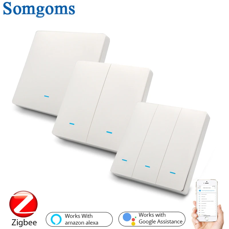

This should be the one (3-gang with neutral): Lonsonho Tuya WiFi Smart Switch EU 220V With/ No Neutral Push Button Light Switches Multi Control Association Alexa Google Home|Switches| - AliExpress
Wait!
We r talking about zigbee switch, not wifi.
This is what i ordered and has the same fingerprint what you have:
Yes, Zigbee. There are so many of them I could paste the wrong one. But I wouldn't be surprised if it's the correct one because in many cases for them WiFi = Zigbee.
@mike.maxwell please see the above link. I hope you didn't order just yet!
