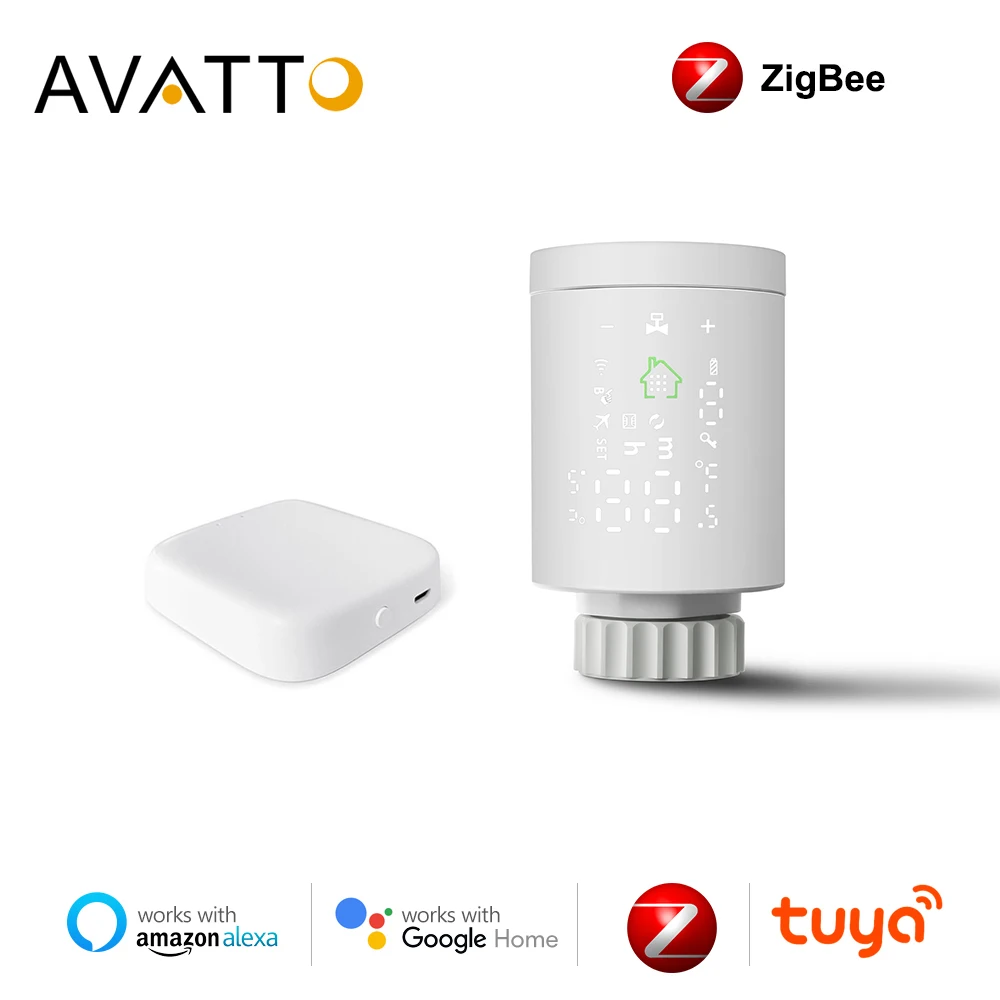

I have two of these and they seem to work ok
US $15.91 30%OFF | AVATTO Zigbee Smart Radiator Thermostat Valve,Tuya Thermostatic Radiator Valve Actuator Controller Work for Alexa, Google Home
I'm not completely decided yet. I've seen a few instances where my radiators have stayed fairly warm but the valve was supposedly set to 0% quite a while ago. This is mainly on the same two radiators so could be an issue with the actual valve rather than the TRV.
