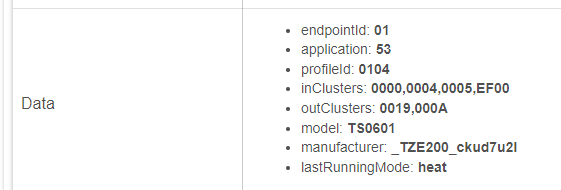

this is my device: Tuya Smart ZigBee Radiator Actuator TRV Programmable Thermostatic Radiator Valve Temperature Controller Support Alexa|Building Automation| - AliExpress
Hello @mark.cockcroft
I have the following zigbee device
The only driver that I could have readings within hubitat is yours
I get the reading of the temperature and I also get the reading of the heating setpoint when I manually change it from the device. The number I get though is exactly half the value displayed on the device (eg. heating setpoint 20degreesCelsius gives a reading of 10 degrees within hubitat).
Also I cannot control thermostat from hubitat .
Is there anything you can do to help or guide me?

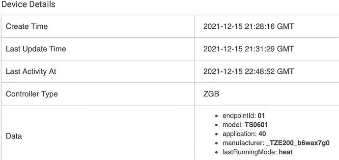

send me a screen shot of the bottom of the device page so i can see the manufacture something like this
If you find this bit of the code (around line 381) and add the extra case in for your manufacture
boolean isMoesModel(String manufacturer=null) {
manufacturer = manufacturer != null ? manufacturer : getDeviceDataByName('manufacturer')
switch(manufacturer) {
case "_TZE200_zion52ef":
return true
break
case "_TZE200_b6wax7g0":
return true
break
default:
return false
These 3 line are what extra to add
return true
break
Hi Mark,
I have done just that. Then refreshed the driver (by "choosing" it again and saving, then by choosing another driver, saving, going back to Zigbee Tuya TRV and saving again), but it looks just the same.
What should I have expected to see? Or what would this have done?
This is what the page looks like:
As mentioned, buy putting, say, 2.2 into the Set Heating Setpoint box, it does indeed change the setting on the TRV. Arguably the most important thing!
