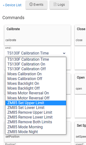

. Thanks for that info, although I'm now wondering whether I'm using the right driver - this is what the device list entry for my blinds looks like:
...AFAICS, no sign of that Calibration dropdown on my screen (or of the text fragment "calibr" when I searched the driver source).
My local driver's "ZemiSmart Zigbee Blind", downloaded via HPM, and its documentation link in HPM points to:
which (again) AFAICS is the same one as we'd been discussing earlier in the thread. Have I missed a step somewhere?
The correct repository in GitHub is this one :
It was changed about 10 months ago.
From HPM app, try repairing the package.
The latest driver version is 3.3.0 , dated 2022-12-30.
Ah - ta. Somehow (possibly a consequence of me manually swapping patch versions in and out last year) my local copy had got locked into an old version (3.0.0), and HPM wasn't picking up that updates were available.
A repair didn't fix this, but a full uninstall and reinstall did - now on v3.3.0 and seeing the new calibration settings. Thanks for your help! ![]()

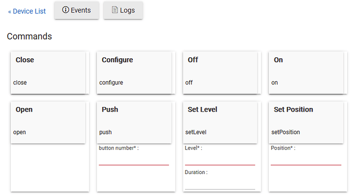

Boo. I can't see the current position, but I can set position and fully open and fully close...

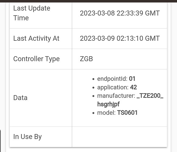

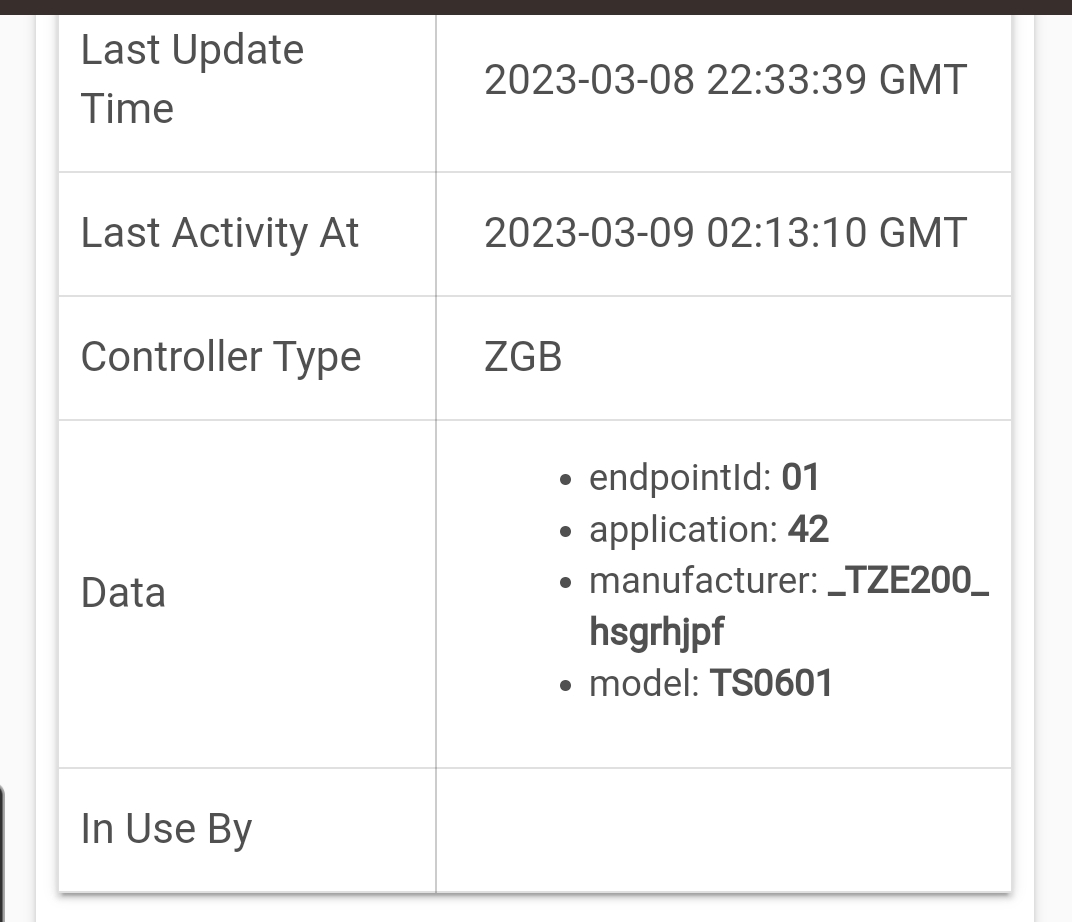

Can you temporarily switch the driver to the inbuilt 'Device' and click on the 'Get Info' button - I need the device detailed inClusters / outClusters data. I can't find a post in HE forum for _TZE200_hsgrhjpf , so seems like it is a relatively new device.
Do you have the motor limits set?
Is this a 220V or 12V motor?
