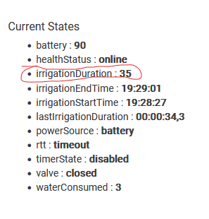

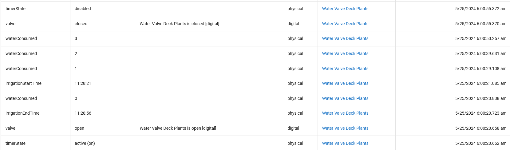

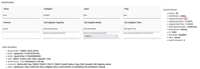

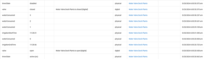

It sounds to me like you have an auto off timer set either based on time or volume. Do you have something like this on your device page?
Incidentally, I very much prefer to use the duration command rather than seperate on and off commands. It seems to be much more reliable for these "close to the edge of the mesh" devices, which most outdoor devices are.
