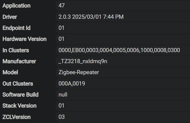

I bought 2 of these Lincukoo (Tuya) thinking it may be helpful in my shed. There are 5 devices out there and I just wanted to make sure I had a good, strong signal. Sometimes a device will attach to the house and its LQI is poor then.
I have had a mini repeater (and 5 in the house) there with no issue so far.
I have tried 3 drivers and different power USB bricks but after 2-4 days each one goes offline until I reset the power.
At first I thought I just had a bad device but they both do it.

That’s exactly the product I’m dealing with.
