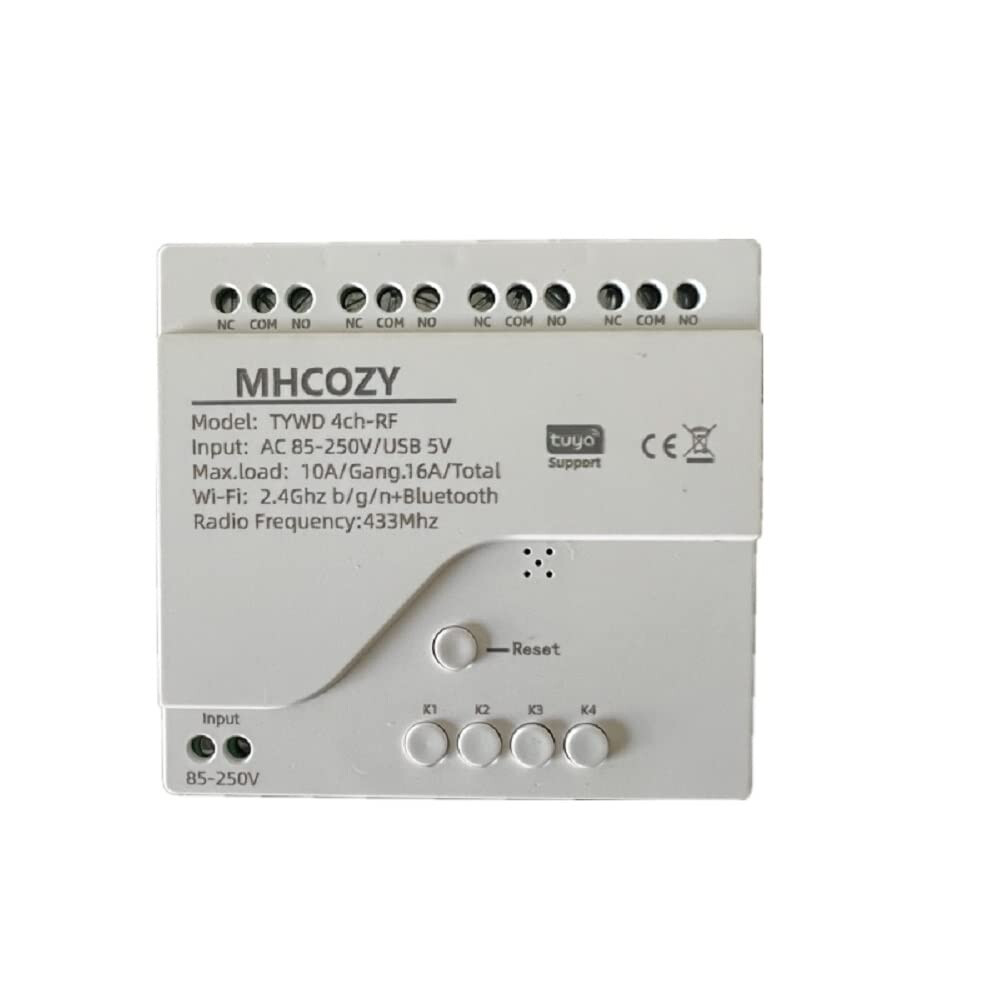

So, I want to have a couple of WiFi relays (maybe these 4 Channel AC 85-250V Smart WiFi Dry Contact Relay Tuya)
This is a WiFi device, but I have had limited luck using Tuya devices.
Is there a device driver I can install to get the job done? Are there special instructions for said driver?
Thanks, Mark.
you sould use the Tuya SmartLife app and bring that device into HE via the Tuya integration.

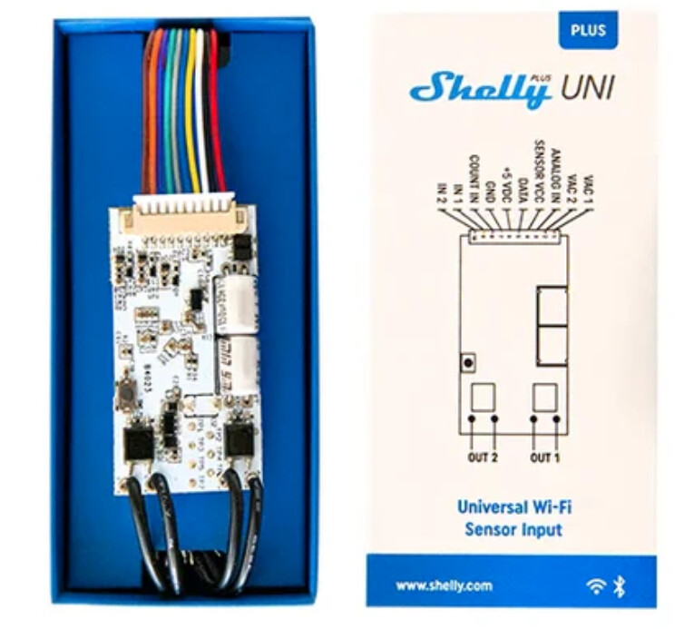

How about the sort of relays but definitely Wi-Fi Shelly Plus UNI? :thinking:
I have a Shelly in my shed and it works great. I use it to monitor the DC voltage of my security camera backup system as well as one of the relays to reset the cameras when needed
