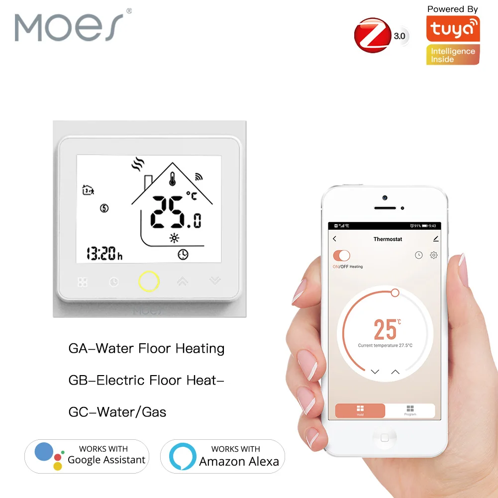

Is your wall-mounted thermostat like this one?
I have its basic functionalities working fine with HE and a customized driver.

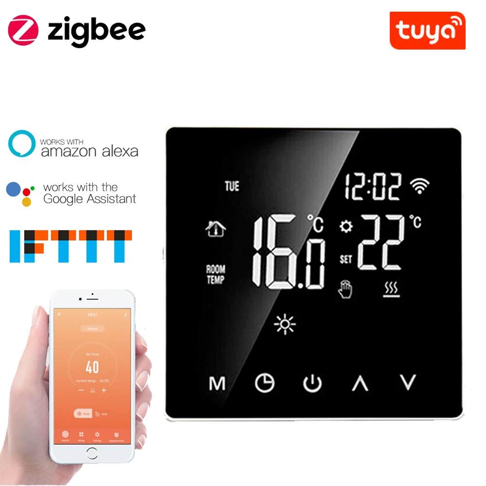

I have thermostats like this:
Do you have that driver? I’d like to test it with one extra thermostat that is not in use at the moment.
I have sent PMs with the link to the developments version of the driver that needs volunteers for preliminary testing with thermostats different than mine :slight_smile:
Hopefully I will be ready to publish the driver this weekend.
