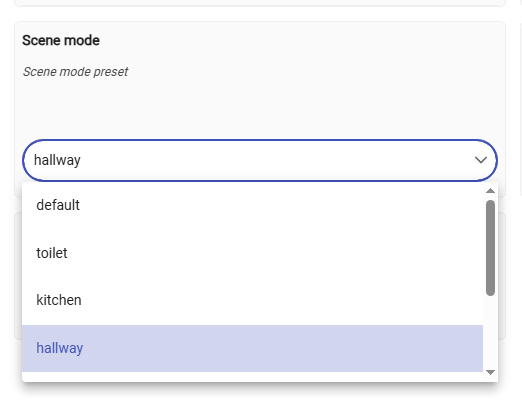

I have doubts that sending the 'Scene Mode' preset each time you click the 'Save' button in the Preferences tab resets the sensor... : (

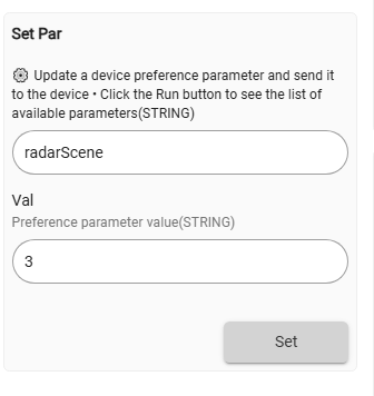

Can you do the following :
From the Commands tab, enter 'radarScene' with parameter value 3 in the 'SetPar' command :
Then click on the 'Set' button. Do NOT change anything from the Preferences tab!

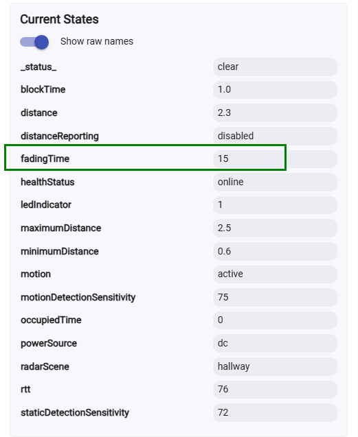

Will the 'fading time' be reported back as 15 seconds? (this is the 'Hallway' preset value)
Please note that 15 seconds does not always equate to the device reporting 'motion inactive' precisely 15 seconds after leaving the room. The speed at which the device indicates no motion (no 'presence') depends on many factors, especially on the static detection sensitivity.
There is always a trade-off between stable micro-motion detection and quick 'no motion' reporting.
