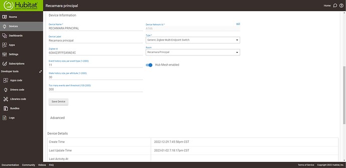

I've already pairing whit my hubitat hub, but not respond, no on and off, I already try using the app code that I found here, but in the moment I save it throw me an error, I left here some screen shots

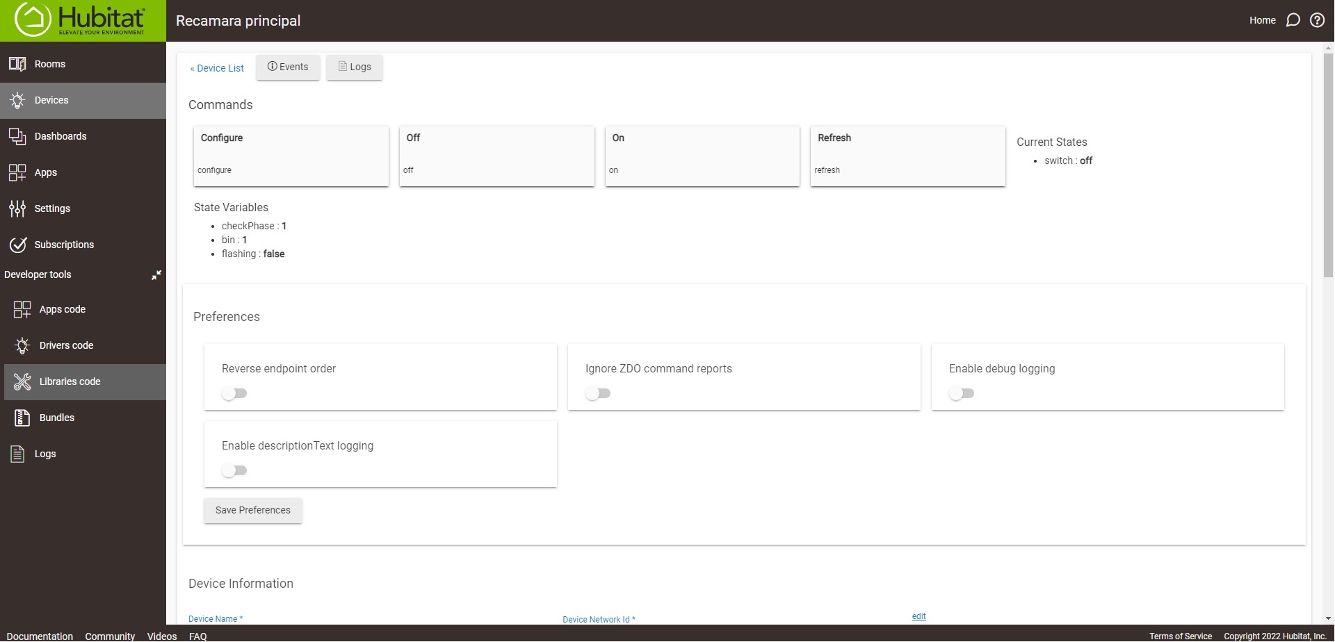

After successfully installing the driver, the best approach is to delete the device from its web page ( "REMOVE DEVICE" button at the bottom right of the page) and then pair the device again to HE.
Hi, I already archived to work, thanks a lot for that, now I have a doubt, every time the electricity go off I have to remove and add the switch? It happens 2 times, I switch off the electricity in all house and the switch wall don't response :pensive:, there's any thing I can do for this inconvenient?
