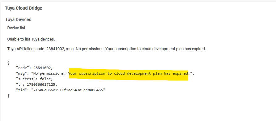

I’ve hit a practical wall with my Hubitat → Tuya Cloud integration project: Hubitat-Tuya-Cloud-Bridge.

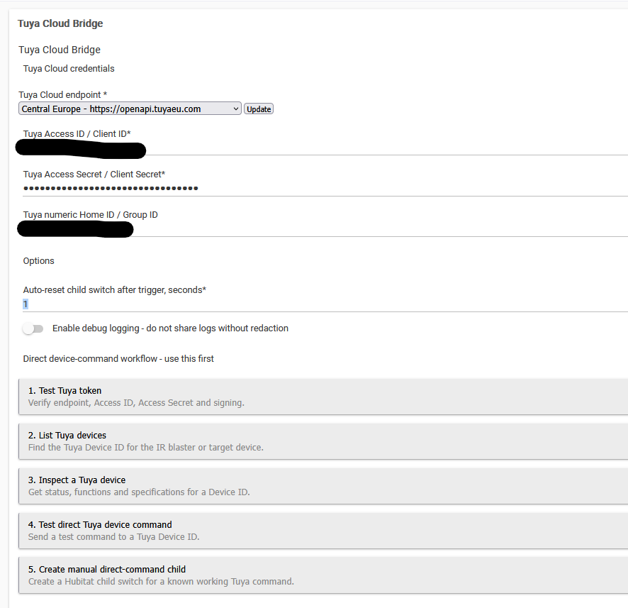

The Hubitat app can authenticate successfully and obtain a Tuya token, so the credentials, endpoint and signing logic is working.
The failure happens after authentication, when trying to access Tuya devices or scenes. Tuya returns: No permissions. Your subscription to cloud development plan has expired.

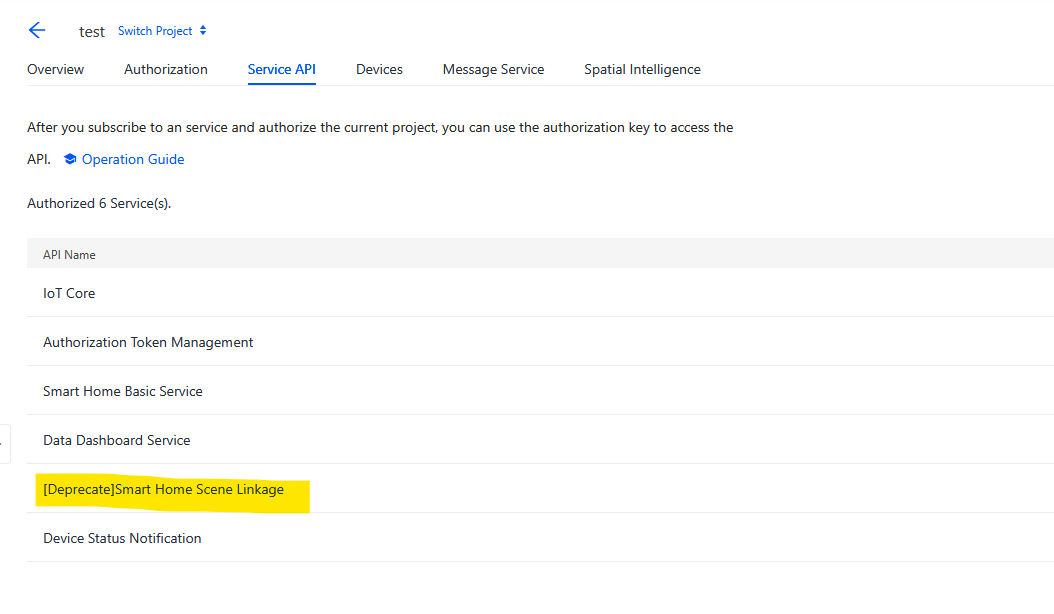

The confusing part is that the project still shows several authorised services, including IoT Core and Smart Home Basic Service, while the scene-related service is marked as deprecated.
So the issue appears to be Tuya’s cloud entitlement model rather than the integration code itself. Has anyone found a practical workaround for this, other than creating a new Tuya account or a fresh Tuya project?

In the Tuya Developer Platform, the project has several services authorised, including IoT Core, Smart Home Basic Service, Data Dashboard Service and the now deprecated Smart Home Scene Linkage service.

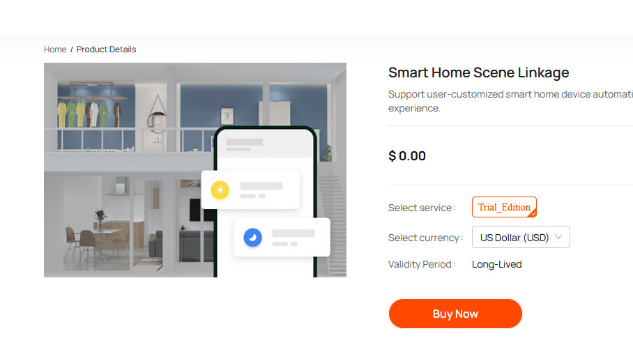

This used to be a free service, but I cant see any way to reactivate it, even via a paid upgrade;

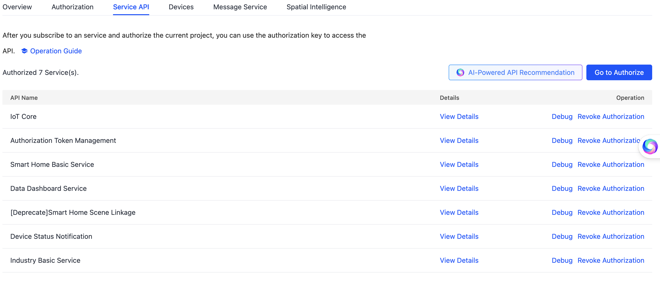

The "industry basic service" is missing from your list, compared to mine.
As far as I remember, between signing up years ago and a few months ago, the features required from Smart Home Scene Linkage were moved to IoT Core and/or Smart Home Basic Services and made free.

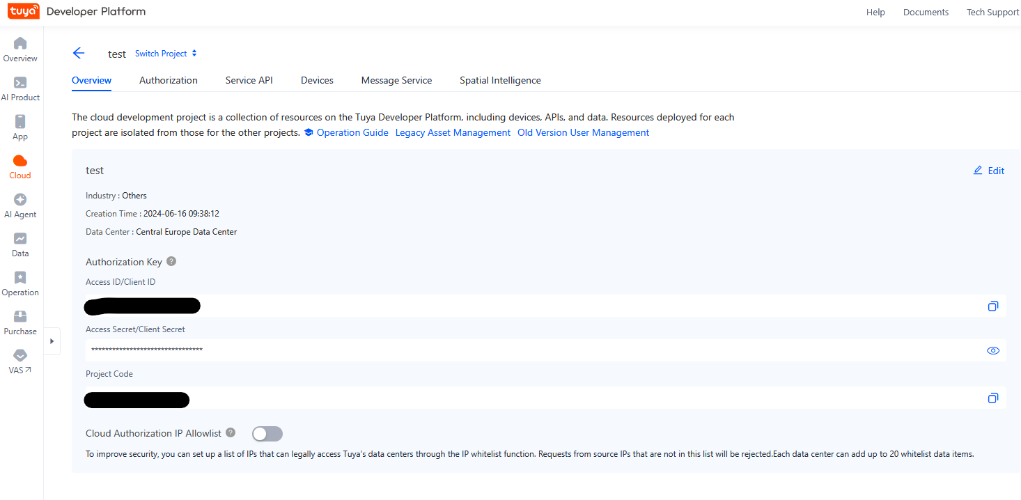

I did a full test last night again, so I blew away the existing Tuya project and started from scratch. This time I added what looked like the right Cloud API entitlements from the Tuya cloud side.
I then managed to bridge my Smart Life app back into the project. From the Tuya portal I could see my devices , inspect permissions, and change access settings. So the account linking side appeared to be working.
From the Groovy code in Hubitat, I could also successfully reach Tuya, authenticate, and acquire a token. So the basic integration path works.
The problem was that every useful API call still came back with the same permission / entitlement failure, saying I did not have access to the required API services.
After digging further, it looks like Tuya may have deprecated or withdrawn some of those API entitlements for new individual hobbyist developers. Apparently they have kept access working for existing users who already had those API services enabled, but new users/projects can no longer get access to the same APIs.
It may simply be that the required cloud API access is no longer available to new individual users in the way older integrations expected.
