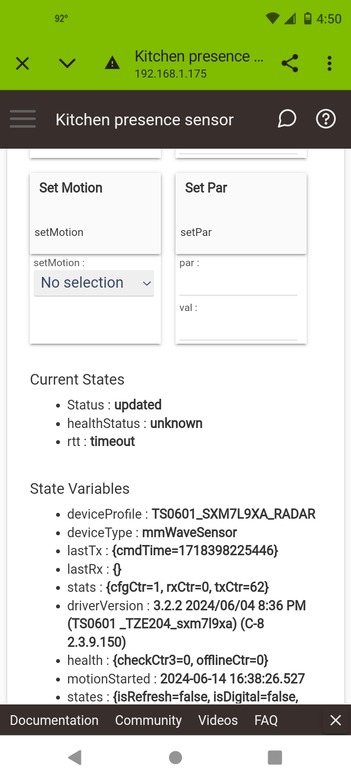

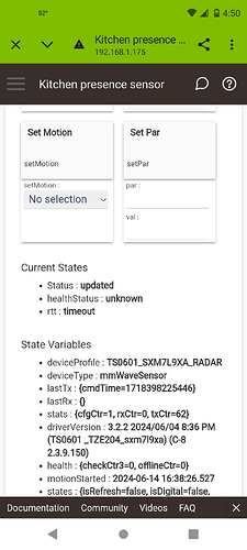

Added a driver for tuya battery radar detector and it mess up my 4in1 driver. Now my kitchen detector is not working. No longer shows activity
There is nothing received fro the device - does the ping() command work?
