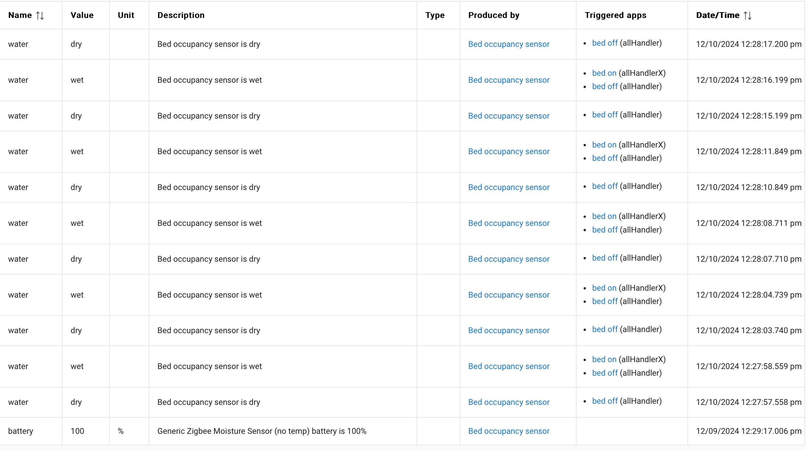

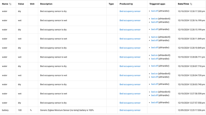

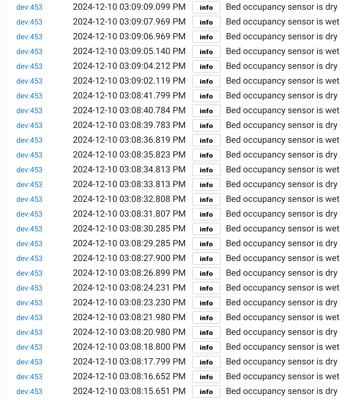

I managed to cut the siren cables in my thirdreality leak sensor(it was an easy process), and so far the pressure mat with the sensor is working fine. Although, it is very very spammy/noisy - when you look at the logs(look at the picture). Whenever someone sits on pressure mat - the leak sensor almost twitches between "wet" and "dry" frequently as long as someone is sitting. It stabilizes on "dry" when someone is off. So I have to create a virtual switch just to pad out the noise to create a stable "occupied" and "un-occupied" stating device of which I can build my rules on.
Two things:
  1. Does the aqara leak sensor twitches/toggles the same way whenever someone sits on your pressure mat ?
  2. You brought up my second concern - how long do these batteries last ? given that these leak sensors were made to be dry/disconnected in normal circumstances and only go "wet"/connected if there is water detected - usually this "Wet" state is temporary. Does the battery drain a lot if someone was to sleep on this bed for 8-10 hours while this sensor is in "wet" state for that long

The Aqara sensors do not twitch between we and dry. When no one is on the bed they are stable on dry. When someone is in the bed they are stable on wet. I have a pad on my side and one on my wife's side. They are both stable if laying in the area of the mat. I actually turn her bedside fan on with hers when she gets in bed. I also use them to make sure the lights don't come on when someone is in bed and someone else walks in the room.

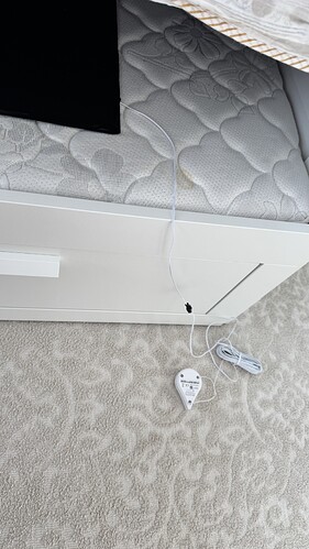

I got this from amazon - Navaris Pressure Mat Alarm and Doorbell - Mat with Connecting Cable and Alarm Bell - Security Mat, Use Indoors Or Outside, 35.4" x 15" : Amazon.ca: Electronics
Its large and its has a very convenient clip on the end of their power cables that can by easily connected to any leak sensor.

I have attached a picture of the mat that I use. It is very similar and has a very similar cable. One thing I done was put a hard flat surface between my mattress and the structure below it so the mat was laying on that hard consistent surface and then the mattress against the mat instead of one that was uneven. I actually used a couple pieces of left over laminate flooring.

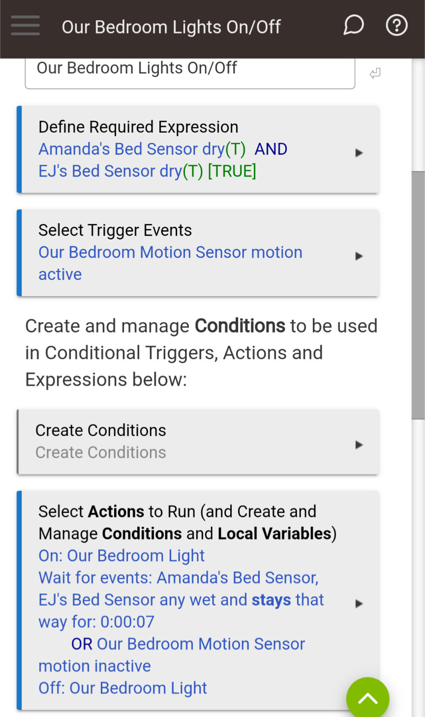

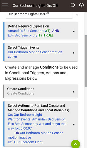

Also I have attached a screenshot of my rule. I use the wet dry state. I do not use any virtual switches.

Thanks for posting the rule - I was thinking of the exact same thing. Automating my bedroom lights based on motion if no one is in bed.
Great stuff!
That rule works really well for me. The required expression of course keeps it from triggering if anyone is in bed.

Tonight I will get you a pic of the matt installed. Also, one other thing I did find it helpful to put a thin towel on the edge of one of the mats. I am assuming that is due to mattress shapes. It really is just a trial and error thing to get the mat to work how you want.

From your earlier message, I figured out a mistake I was doing. I had just placed the pressure mat directly on the bed slats. Which is probably why it was fluctuating between wet and dry.
I’ll try to find something hard, flat and large to put under

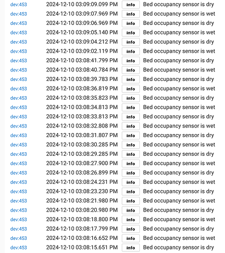

This is how it is now behaving with me standing on top of it while its placed on the floor.
One way to test is take the mat wires loose and just use a jumper wire to trip the leak sensor and see if it toggles back and forth like that. If it doesn't then it could be the mat.
Mine when I broke it basically a huge portion of the mat stopped responding all together but depending on how it is broken if it is then you may get a different reaction.
just did that.
It is the third reality leak sensor behaving erratically.
Now I am not sure if this was its default behavior or did I cause this when cutting the siren off.
Time to get another TR water sensor to see if its behaving the same way
