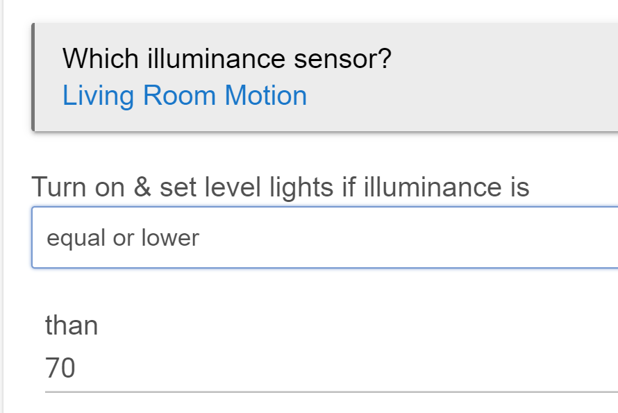

For me, my living has recessed can lights so I put the sensor up high and they basically have very little effect on the value... I don't worry about time of day, angle of sun, curtains open/closed as all that is controlled by the illuminance, been using it this way for over 2 years and it works great
One thing I did have to play with initially was the turn on and turn off values to help reduce the popcorn effect
Here is my on
