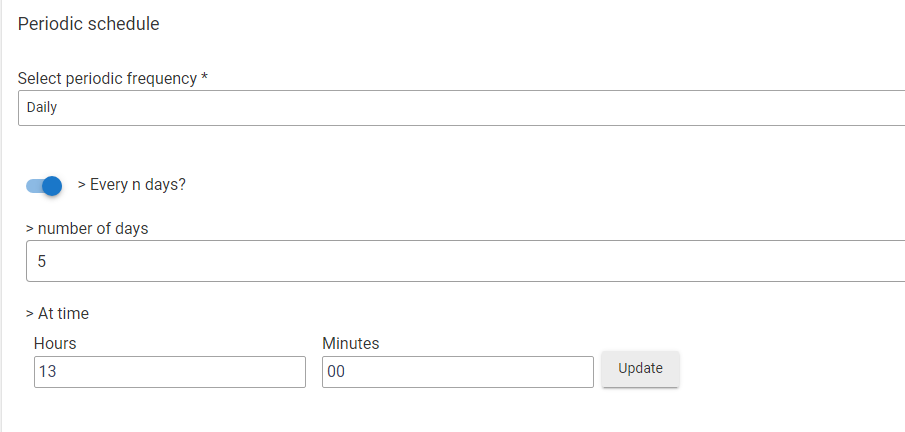

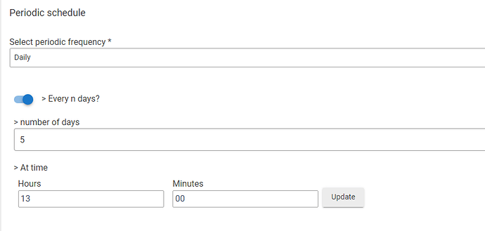

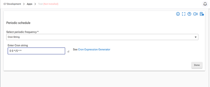

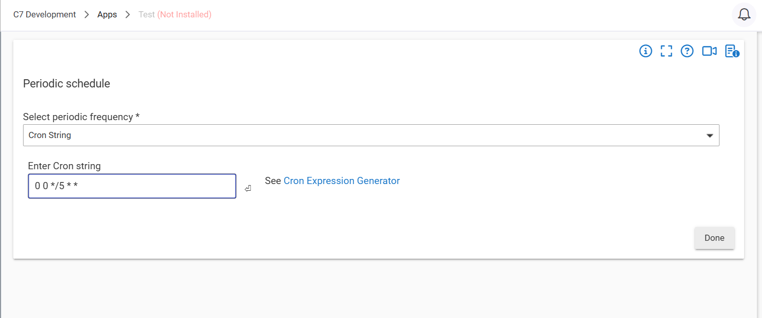

Link to the Cron Generator is on the RM screen but this trigger should work for you (runs at midnight every 5 days):
In rule machine you can do periodic schedule every n days...
That is PRECISELY what I was seeking. Thanks very much!
