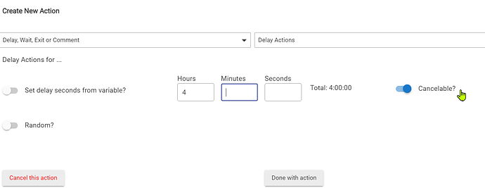

Rule Machine example screenshots
Start a new rule. First thing you do is create the trigger, in your case, based on time (and maybe date):
2024-05-30 18_22_58-C8, C7, & Misc Hubs
2024-05-30 18_23_32-C8, C7, & Misc Hubs
2024-05-30 18_23_44-C8, C7, & Misc Hubs
2024-05-30 18_24_03-C8, C7, & Misc Hubs
2024-05-30 18_24_15-C8, C7, & Misc Hubs
2024-05-30 18_24_34-C8, C7, & Misc Hubs
2024-05-30 18_24_46-C8, C7, & Misc Hubs
2024-05-30 18_25_56-C8, C7, & Misc Hubs
2024-05-30 18_26_27-C8, C7, & Misc Hubs
Now you have the first two actions...
2024-05-30 18_27_10-C8, C7, & Misc Hubs
Next you need to add another action (again a "Run Custom Action" to delete the code after the desired time:
2024-05-30 18_27_18-C8, C7, & Misc Hubs
...and so on...
Create one rule for each lock code you want to set/remove at specific times.
Dive in... :slight_smile:
