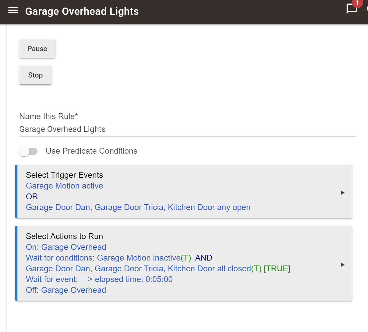

Here is my Garage Lights RM 5 rule that I recently rewrote and it works very well for my needs. Basically, if any of the doors to the garage are open, or there is motion in the garage, then the lights stay on. Else, they turn off after 5 minutes of no motion and all doors closed (i.e. nobody is in the garage.) Hope this helps!

Take a look at the first WAIT condition, as it relies on No Motion - AND - All Doors being closed, before proceeding.
Give it a try... It works as expected due to the fact that RM cancels any existing WAITs if the rule is retriggered. As long the rule is retriggered by motion in the garage, between the time the door is closed and the five minute wait expires, the lights will stay on.

So first time the light is turned on by by a contact sensor, it skips the wait for inactive because it is already inactive, now it is stuck in the wait for all doors to close.
If I close the door without never stepping into the room it goes into the 5 minutes timer and turn off the lights.
But if I do step into the room I will trigger the motion sensor.
Are you saying at this point RM will cancel the running instance (the one waiting for the door to close or for a 5 mins timer) and start over? In which case it will stop in the wait for inactive event?
If this is the case it should work but it raises another issue?
Isn't it bad (for performance reasons) to have it triggered every 2 minutes for as long as I'm in the room? Because that is how often the motion sensor will be sending an "active" event.
Yes
Yes... But to be clear, it is a Wait for ALL of the conditions (motion and contact sensors), not just motion inactive.
Not at all, as Hubitat basically ignores duplicate, successive 'active' status updates from a physical device. In fact, most motion sensors don't send duplicate events like that, they only send data when the status changes (YMMV, of course, based on the specific hardware device!) In any event, Hubitat de-duplicates the incoming status updates and only creates an Event when the status changes.
Now I get it. I create a rule that looks exactly like yours, did some testing and so far it is working the way I expect it to.
