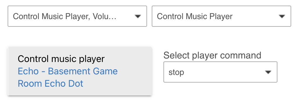

I did a quick check and from what I can see, the Google devices do not come up in the list of music devices. I have Echo devices and those showed up:
@gopher.ny, is the ChromeCast integration not able to control play/stop/etc…?

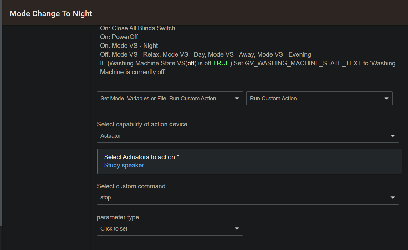

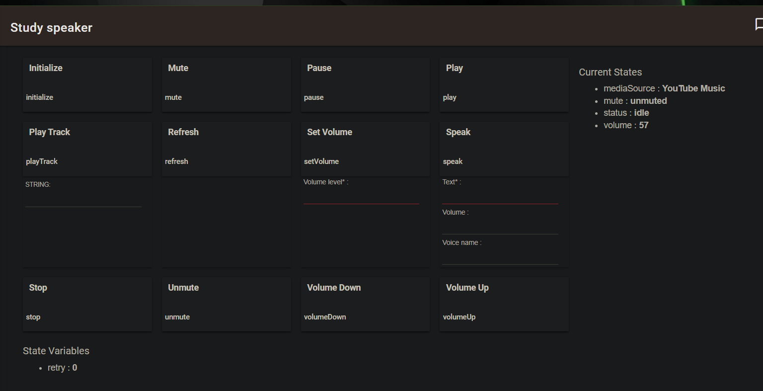

Do you not see these commands in the device edit page for your speaker? You can call the Stop command (bottom left of my screenshot) as a Custom Command in an RM Rule which should stop the playing of the music. That said, I had some mixed results earlier this morning, but that could have been to do with high CPU load on my hub...
Set Volume should also work if you want to use that.
I am down to try that. I've not done a "Custom Command in an RM Rule", but can probably figure it out - where do I start that?
The thing that most people are not aware of when I they start to use these is to select the Actuator capability. It's not a requirement, if the device includes other capabilities, it's just a way to restrict the list of devices.

I've been playing around with mine this morning and have been able to mix control between my phone and Hubitat. I cast from the YouTube Music app on my phone, then was able to control the volume via a dashboard tile via Hubitat, as well as calling the stop command to stop the cast. Like I mentioned in my earlier post, I did experience some issues with this (I suspect) when the HE hub was under load.
