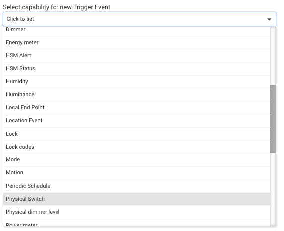

How do you set up a rule to detect physical events and not digital? I can't find what to use.

You have to have an event for a rule to run. Does the power going off and coming back on cause an off event? I doubt it.
I would think just checking the state of the switch every 5 to 10 minutes while you sleep would be a simple solution. You set a virtual switch, or a boolean varaible that turns on when you go to sleep, if the fan is on. So if the virtual switch is off then don't run the rule. Reset the switch every day when you get up.
I'd be surprised if a power outage shows as a physical event. I think it's worth a try and please let us know the results if you do. For testing, maybe make the repeat 2 or 3 minutes so you don't have to wait so long to find out if it does work.
Back to the drawing board. I cut the breaker to the bedroom, and even let it sit off for a few minutes. As soon as I turned it back on, nothing. Checking the logs, it's showing the fan turned off physical and on physical in relation to the breaker being off and on. What's odd is while power was out, the fan was showing as still being on in the dashboard. So, not sure why that would be.
But, in any event, when power goes out, HE ultimately thinks the fan was turned off by the physical switch. So that pretty much rules out any kind of virtual or actual device that basically mirrors the fan control as a way of remembering the state.
