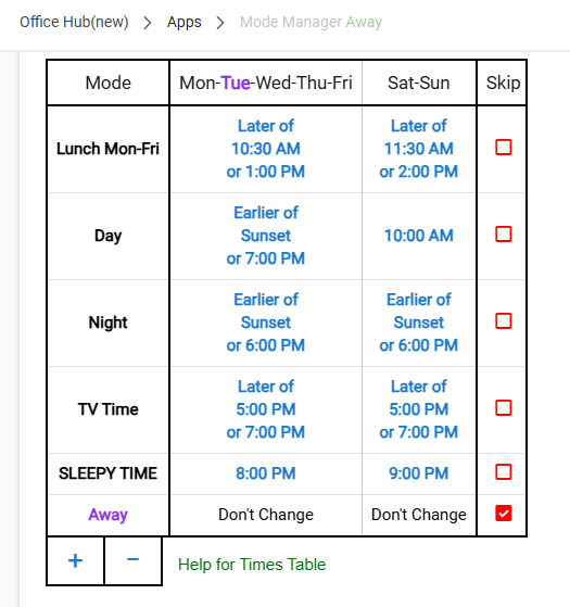

I don't like to use modes because I can not get them to work. I will provide a screenshot. Perhaps you can tell me what it wrong with them.
All the Modes are setup just for testing. The AWAY works okay.

Although it's still available to use, the legacy Motion and Mode Lighting app is no longer being actively supported, and has been superseded by the Room Lighting (RL) app.
As RL is now the heir apparent, I would suggest looking into using that -- it enables you to set activity by Time Periods (so similar to modes, but smaller / more localized scale).
