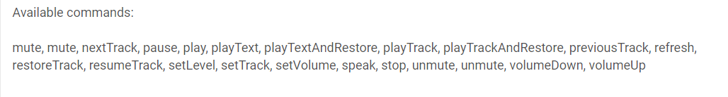

The only available commands I have are these (Sonos speaker)
No, then. You are sort of out of luck since the Sonos interface does not have a voice parameter input during speak nor playText.

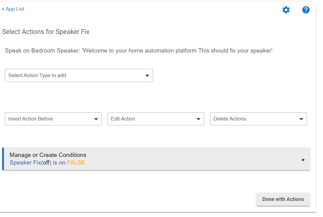

I have a completely random clicking coming from one of my google home speakers (nothing in the logs about it) and about the only way I can get it to stop clicking (without powering it off for an extended period) is I created a virtual switch that makes it speak for a long sentence. After the sentence the speaker usually stops clicking.
Reason I ask for the character limit is this is the rule that the virtual switch runs.
And everytime it stops speaking on the word "This"?
Any ideas?
There is no limit...
