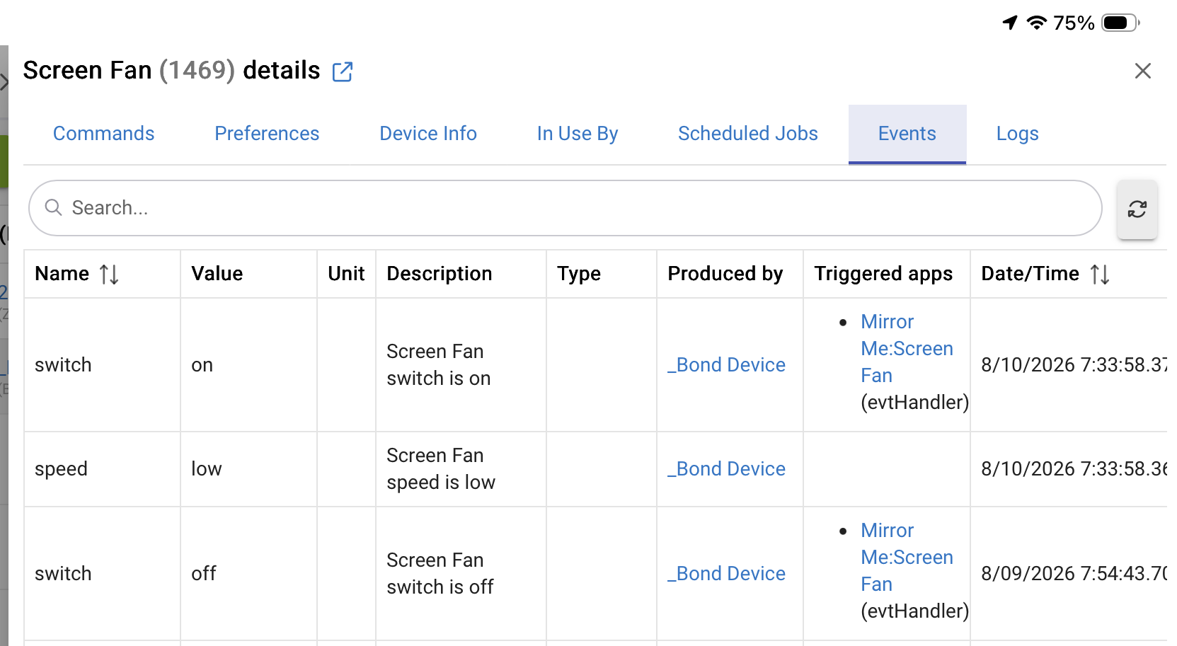

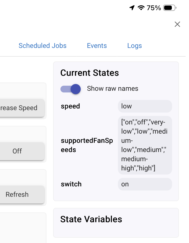

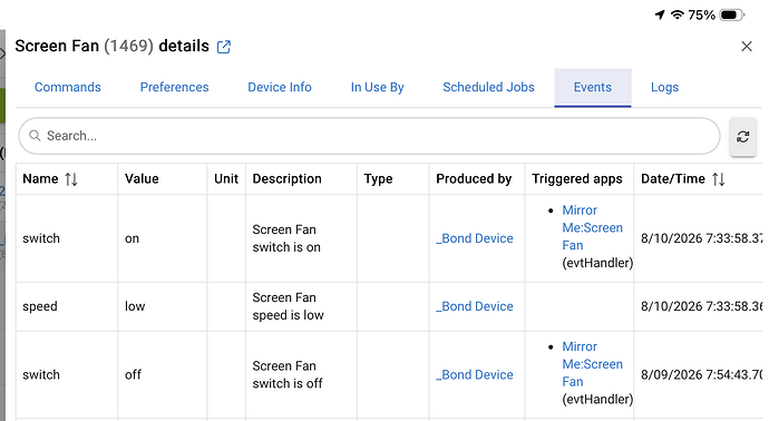

Try triggering on ‘custom attribute’, ‘switch’, ‘on’ on the fan child.
This works: Here are events when I sent “low” command via Bond.

I never considered this option as I always assumed you could get no feedback from the device. You are right, however, my Bond fan has a custom attribute called switch. So that would seem to work, never tried it however.
