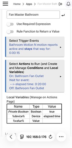

Here is a screenshot of the rule I wrote for a cause very similar to yours. It works fine with no issues. Sorry for the phone screenshot but I am not around my PC
You can modify the settings of course but it will help with the structure.
