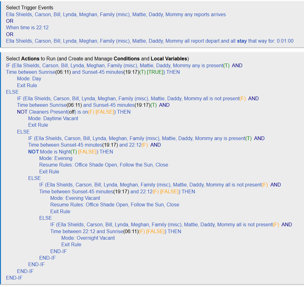

Essentially if mode changes to a 'Day' oriented mode (like "Day" or "Daytime Vacant"), it will immediately apply and then immediately following apply "Evening" or "Evening Vacant", I think if it's after 12ET but not sure.

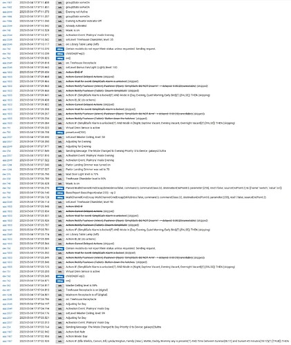

I have my own version of mode manager, screenshot below, which determines mode based on time and presence. The rule itself seems fine, but it's possible that it's looping or being re-run really fast and I can't catch it. But thought that would show in logs, which it doesn't. I screenshot'd the mode manager rule, cleared live logs, ran actions and screenshot'd logs under.

What is "Palmyra Mode Evening" in your logs? That transition seems to trigger some events, but is not listed in your rule.
Those (2057, 2049) are two different room lighting apps being trigger based on the actual Mode change I'm trying to isolate/detect
How is Night Mode activated? I see that as a condition, but it is not set via your rule. Where is it set?
I have another rule for setting night mode. I have two pressure mats under our positions in bed that when both closed for over a minute and our bedroom door is closed and it's evening and after a certain time, plus a double tap button via zooz dimmer for manual trigger.
