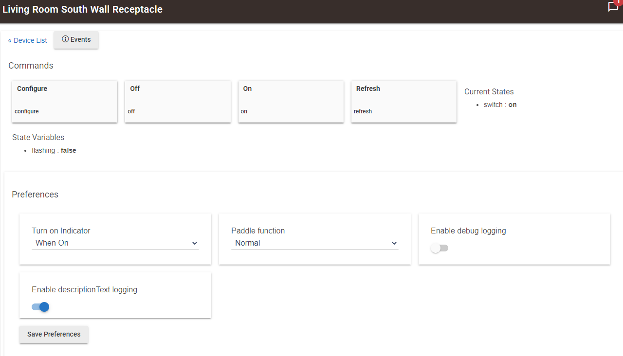

I thought I knew this, but let me double check... Are you talking about these settings:
I thought I had everything logging-related enabled for normal use, but I'm wondering if you saw (or didn't see) something in my logs. Thanks for the follow-up!
Yeah, "enable debug logging" toggle in Preferences section. That'll cause device events to log on both source and destination hubs.
