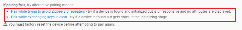

I got it to pair. :smiley: I saw two options I've never seen before...
Tried the last one first, since it looked to fir my issue the most but it didn't work.
Tried the first option and BAM, went to naming the device right away. :slight_smile:

If we were able to automatically detect the situation that option one resolves we would do so.
