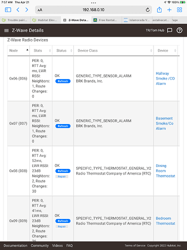

Can you post a copy of your z-wave details page? Does it even attempt to pair? Also what firmware is the lock on?
The Z wave log is blank. The lock and hub do try to pair (lock blinks yellow as it should). Not sure about the lock firmware. Can’t find it in the manual.

That may be your problem. You are on 6.8, anything below 7.10 tends to be a major issue with the schlage locks and pairing with 500/700 series chips.
