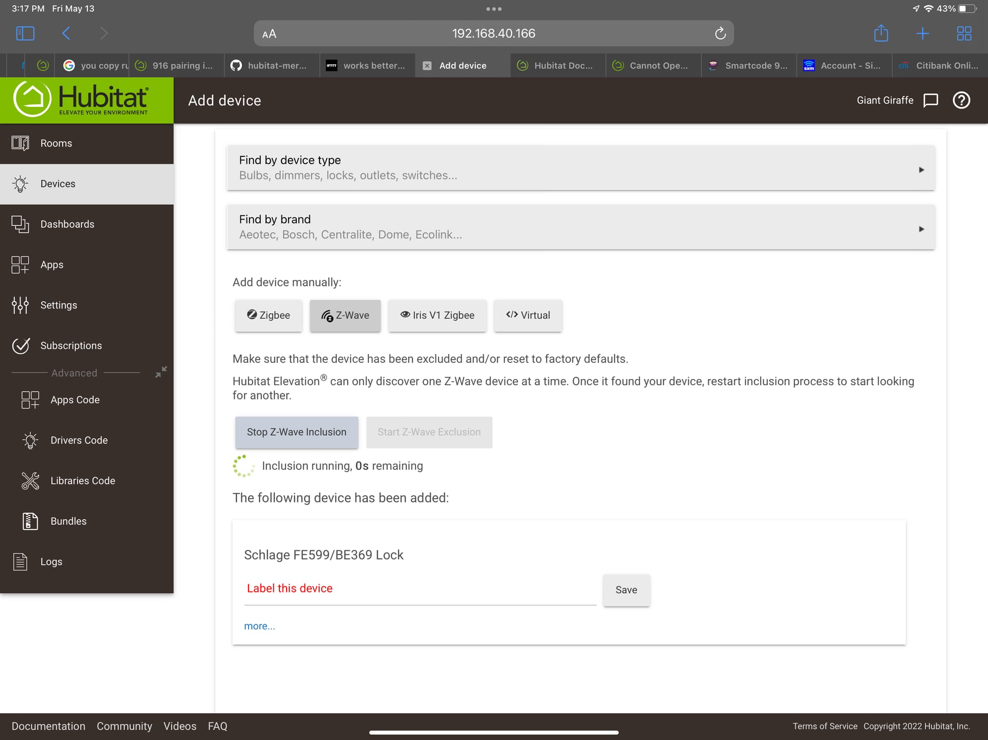

I have a 916 and I am trying to pair it to a hubitat hub, when I start zigbee inclusion it tells me to press the A button four times, the instructions tell me to push it once, I have tried it both ways and I can not get it too be picked up by the hubitat hub, I can’t even get the lights to flash green, if I hold the a button down for ten seconds the light goes red for a sec and the goes off please help

I go it. When I went into Hubitats add device, and tried to add it by brand and model, It wanted to do it by way of Zigbee, but it is a Zwave unit, I got it added by way of Zwave, but it came in as a Schlage lock but hey who cares, it works.
Congrats!!! If you have issues then you could set that to be "Generic Z-Wave Lock".
@erktrek is right, the Generic Zwave Driver works best for Kwikset locks - remember to hit configure after changing the driver.
