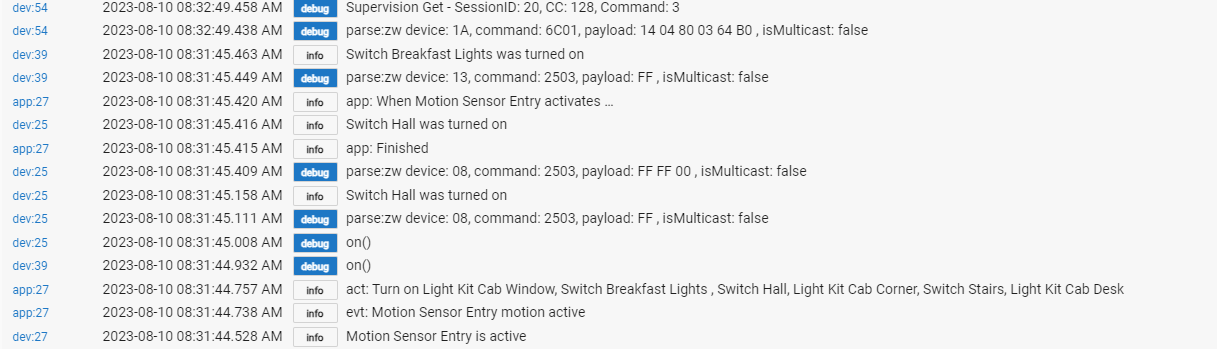

So here's the relevant log entries from today:
Any thoughts appreciated!
That all looks good. Next thing I'd check: on the device detail page for the Hue lights, there is an "Events" button/tab at the top. Clicking this will show up both events (not super interesting here, probably) and commands that were sent. Do you see things Iike "command-on" listed here at the time when these actions were running? This will help determine an app versus device or driver problem.
Yes- definitely see that here on one of the Hue lights. All three have this command listed.
