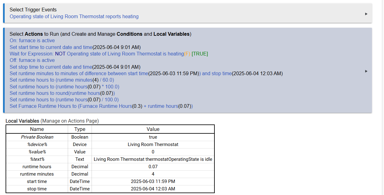

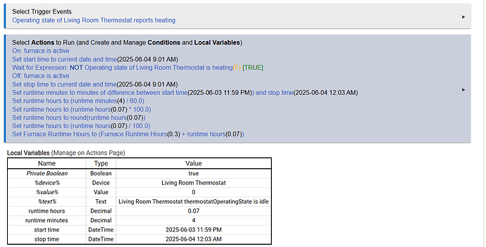

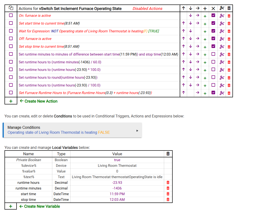

I have a rule that tracks the cumulative runtime of my furnace. It works as expected except for when the start and stop time cross over midnight (the difference between start and stop doesn't calculate correctly), what is the best way to deal with this scenario?
Thanks in advance
After thinking about it, I may have answered my own question. If I set the start and stop time varialbes to include time and date it should correct the final math?

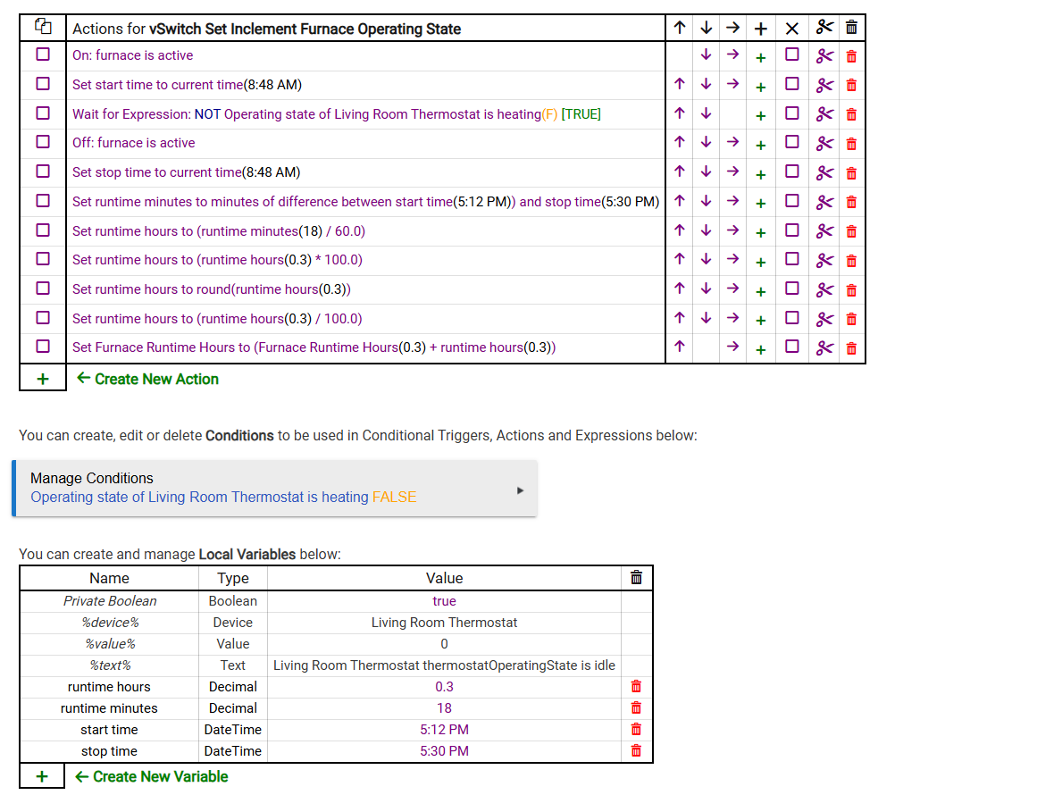

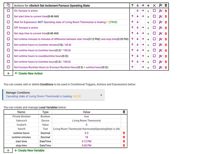

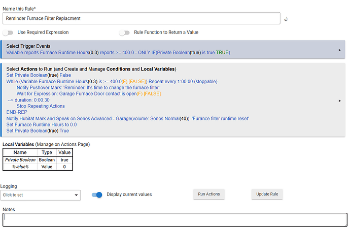

Your app is very close to what I was trying to achieve (seems we think similarily). Only thing I'd love to see is the option to reset it with a contact (my furnace filter door) or a button or switch so I could do it from RM.
This is what I was doing for a reminder/reset as a companion to the RM rule from above to track the runtime.

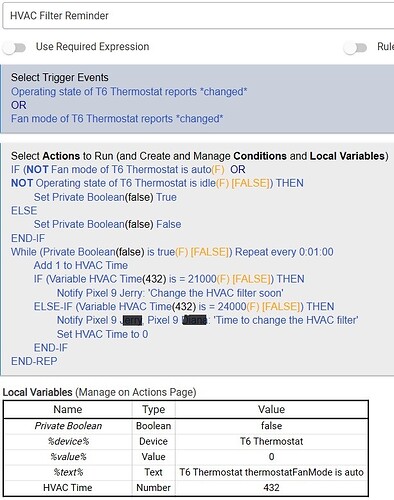

This thread inspired me to make a rule to track the run time of my HVAC. I am on a Honeywell T6 z-wave thermostat. I can detect the fan mode now two.
the number of minutes I used was 350 and 400 hours of fan time from another post. Seemed like a decent starting point.
The example I showed would require less resources as it doesn't have a 1 min reboot loop. Not sure if it's a huge difference to the hub, but seems like it would be more efficient.
The Ecobee driver does, That is probably my largest runtime for my system. I installed a air purifier system on my unit last year and set the ecobee to run the fan a minimum of 20 minutes/hr.
What the loop does only if the HVAC is not in idle. Adds 1 to a memory location, then compares that memory location to a value stored in another location once a minute. Once in a big while, it sends out a notification and maybe writes a 0 into a memory location. All low overhead operations.
If Fan on could move the state off of idle, the counter would start. The thermostat has a circulate mode which the driver is not picking up. I recently moved off of a Nest Gen 3 thermostat I have run for nearly 6 years which did all that in Googles cloud. No Google cloud so I have to write in my own extra features. Like the filter reminder and shut it off if a smoke alarm alerts.
