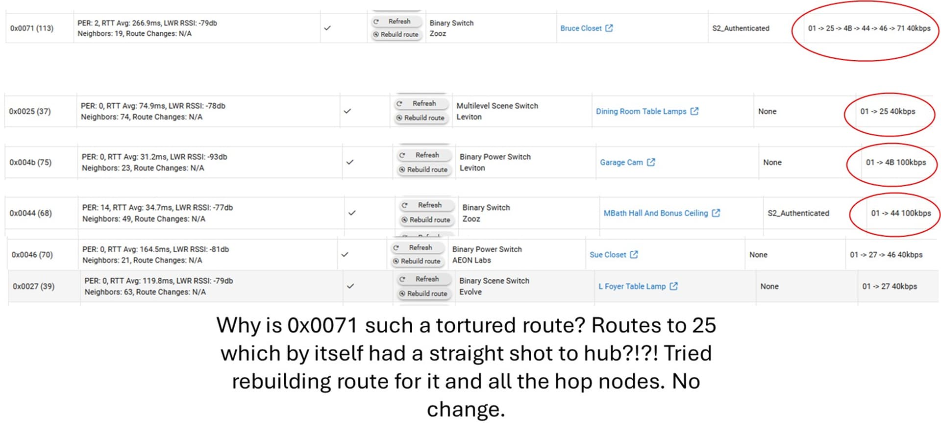

I have one device with a strange route back to the hub. It is quite possible the node has a ZWave "RF hole" but I don't understand why the many hops back to the hub when the first hop to node 25 has a direct shot to the hub? How and who decides how these multi hop routes are built? Can they be reset or over run? Clearly the chosen route isn't the best path.....
rebuild route then refresh. See if it is better.
Technically, yes, per the Z-Wave Spec, but this Applicaton Routing, is not exposed in HE, which does the basic source route (with 5 routes), per the Z-Wave spec. As @TArman nodes, your only real chance of changing this in HE, is to rebuild the route, and as long as the route is working, then it's likely going to stick with that path. You can try physically moving the device, to potentially force a link failure, and then it will try one of the alternate paths, or search for a new path with explorer frames.

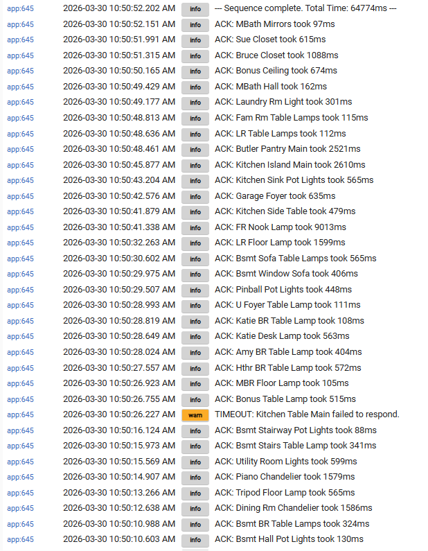

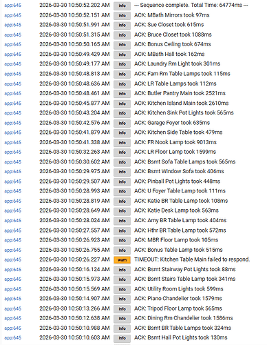

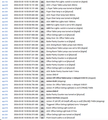

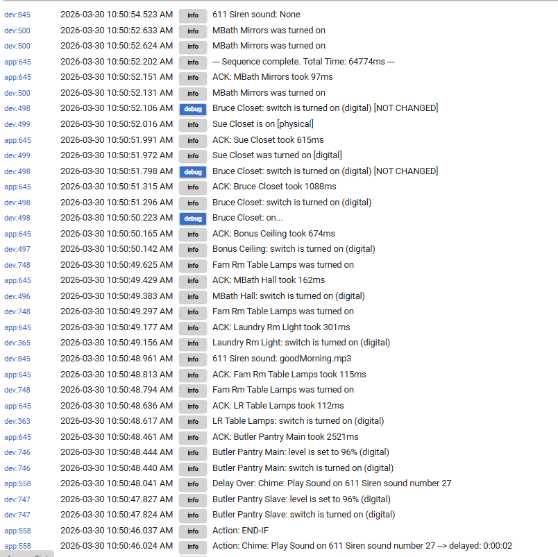

I created an app to sequentially turn on a large number of lights. It waits until the ACK of the prior device before sending the next command in the list. The idea was to avoid flooding the ZWave network with a bunch of near simultaneous commands. The app writes to the log the time duration from command sent to ACK for each device and then the end to end duration of all the devices at the very end. Large variation of ACK durations even those with direct hops.

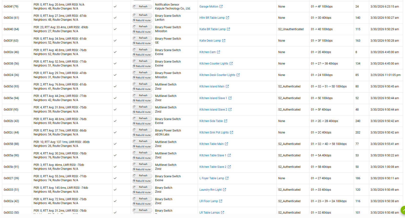

Below is the ZWave entry for Zooz 77 800 series dimmer. It is installed about 6' from Hubitat. Note the 3 hop route. This multi hop is clogging the network with knock on messages that aren't required as the device should direct connect to the hub. I have seen this extensively in this network on many nodes. So much so I coined the term "Tortured Route".
I also can't reconcile the duration variation across devices. FR Nook Lamp (9013ms), Powder Rm Hallway (8232ms), and Foyer Main (7860ms) are all direct routes to the hub. RSSi and PER is nothing unusual. I cant fathom why the long delays..

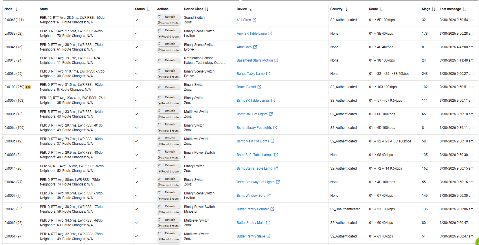

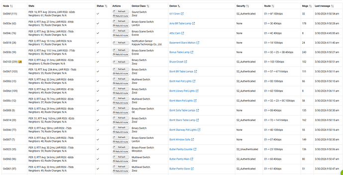

ZWave Device table:

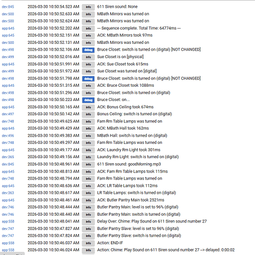

full system logs for same sequence:

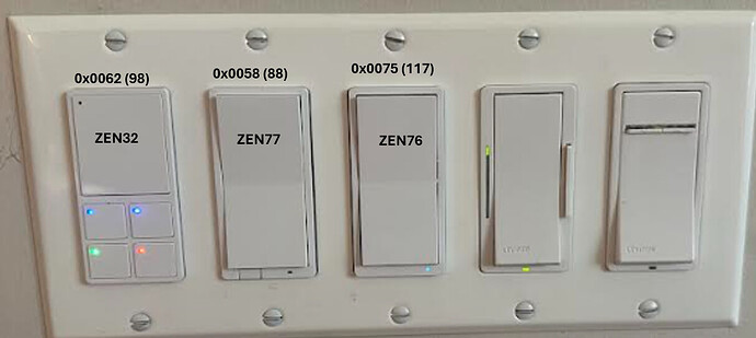

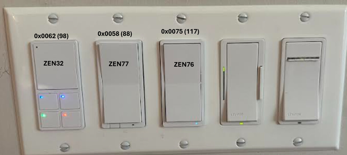

Three 800 series Zooz switches collocated in a 5 gang bank 33' from hub with direct line of sight from face of switches to hub antenna.

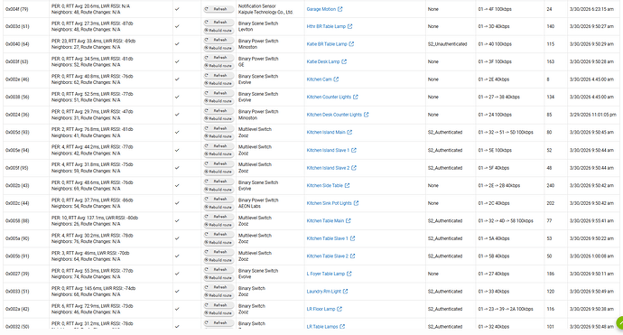

The ZEN76 (node 117) has down shifted to 9.6kbps and after a rebuild/refresh doesn't restore back to faster speed or direct shot. As a result it has a massive RTT of 301ms compared to its neighbors. I tried power cycling the ZEN76 and then a rebuild/refresh but it remained on the 9.6 path.
So I think I'll switch the ZEN76 to LR mode but it shouldn't be necessary given the neighbors performance.
