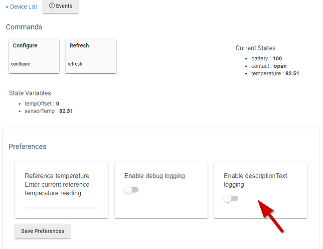

Can you not just disable description Text logging on devices you don't want to see logs from?
I see what he's saying, though - he'd like to be able to see actual events (open/close, etc.) from the devices, without seeing all the temperature reports. Turning off description text logging would stop both.
What driver are you using? If it's not a built-in, you could find and remove the line of code that's outputting the temp to the log; if it is a built-in, perhaps you could find a user-written driver that would work, and could be modified.
