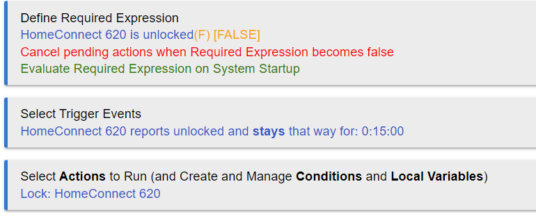

I have a very simple app that locks a lock that remains unlocked for 15 minutes. It was installed last year and has worked reliably up until now.
When I realized it stopped working I added the required expression and enabled cancel pending actions with the hope that that would cancel any previous invocation that may have hung up.

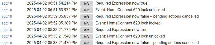

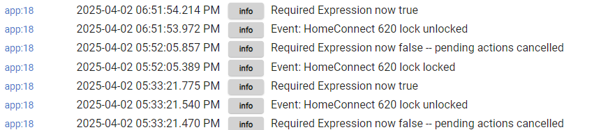

This is the log of the app. At 5:33:21 the lock is unlocked and the 15 minute timer is started. The action that locks the lock does not fire at 5:48 as it should.
I wound up locking it later at 5:52 using a dashboard.
I don't really use Rule Machine, but why do you need the required expression? Can't you just have a trigger for when lock reports unlocked and then stays that way for 15 min? The required expression is really for checking other device states or conditions, not the trigger device itself. My guess is that the lock is locked before it is unlocked, so that is already false at the time the trigger runs.

In this case, the required expression should not be required, so can be removed.

Good thinking but not in this case as you have only one trigger and the stays timer will be cancelled as soon as an unlocked event happens and the actions will not run.
In any case the logic of your required expression is reversed: the trigger event can only happen when the lock is locked, so the required expression as set up will prevent any triggers.

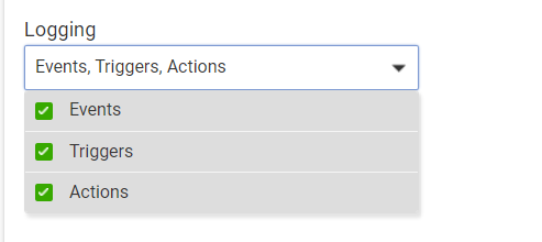

You did not show a log confirming the start of the timer in your screenshot above. Did you turn on all three rule logging options, including "triggers" ? It would look something like this:
The circled i icon used to be a gear icon.
All three selected

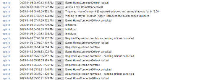

Right. Remove the required expression, press 'Update Rule' or 'Done' and show the logs of the rule running thereafter.
It started working again.
