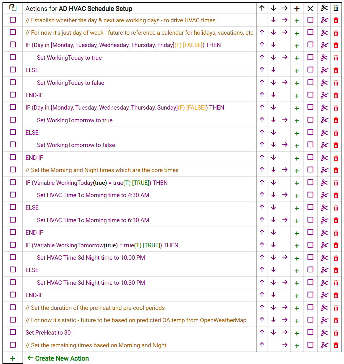

Then I've got a 'setup' rule that will run at 1AM and will determine the times I want the setpoints to change and load them into the hub variables (eventually, it'll also calculate the setpoints which will go to another set of hub variables). Here's what I have on that:
There's a bunch in there that is immaterial to my question and still in a simplified version, but it gives an idea of what I am up to. The spot I'm at now is at the bottom. I've got the hub variable (Time) for Morning time set. I've got the local variable (Number) for PreHeat duration set. I want to see the hub variable (Time) for Pre-Morning to be the Morning Time less the PreHeat duration.

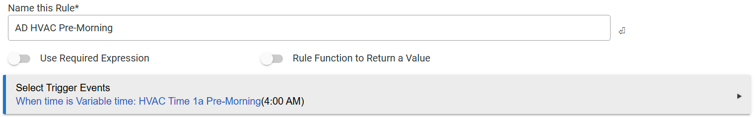

Then, I'll use that Pre-Morning time as a trigger to another rule that actually adjusts the thermostat setpoints. It'll look something like:

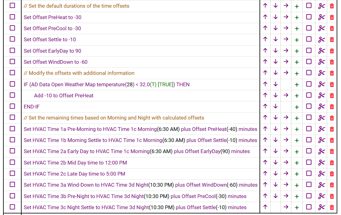

I run the calc in that rule posted above. I added some to the end that looks like this:
You can see that the rule (run shortly after midnight) determines the 'Offset PreHeat' to be -40. This comes from a default and is modified by the outside temperature. That goes into the setting of the 'Time 1a Pre-Morning' variable by being added to the 'Time 1c Morning' variable (which is 6:30AM). Basically, this means I want the start the Pre-Morning period 40 minutes before the Morning period (ie - turn on the heat 40 mins before getting up). So it will set the Pre-Morning time variable to 5:50AM.
I want to update the Thermostat Scheduler so that the Pre-Morning period will be changed from what it was yesterday (6:00AM) to what I want it to be for today (5:50AM). Thus, my heat will come on 10 minutes sooner today than it did yesterday.
