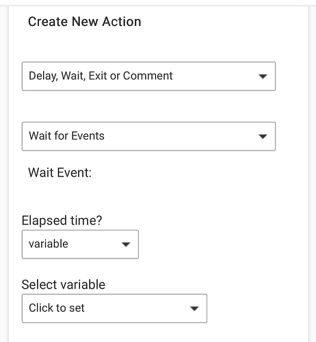

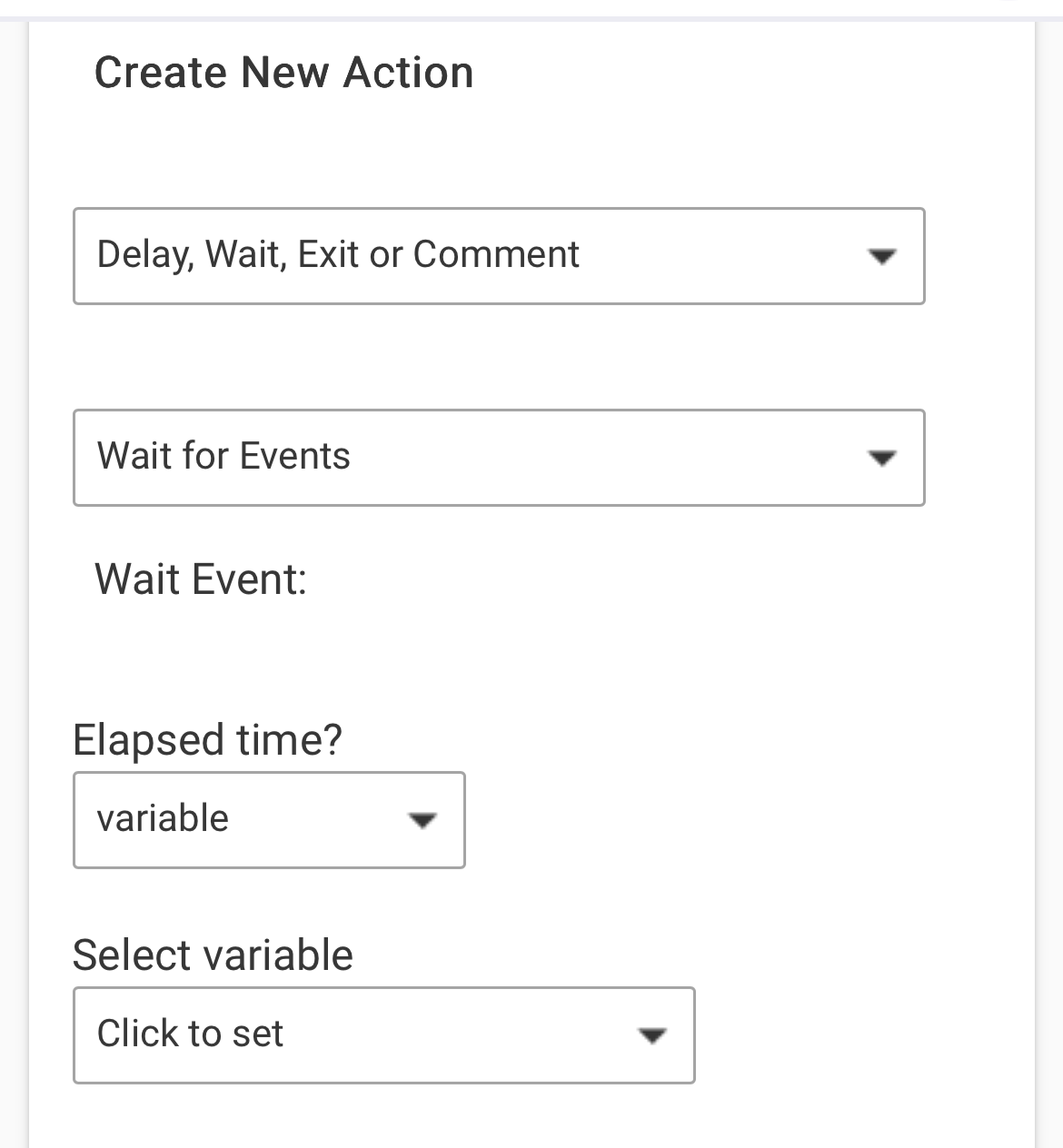

Can you be more specific, particularly with how you want to start the countdown? If you just want to turn a switch off some variable amount of time after it turns on, you don't need "time since." Just create a rule that triggers with it turning on, then create two actions, a "Wait for event: elapses time" using your variable as the time and another that turns the switch off.
Here's how that first action would look when being created:
