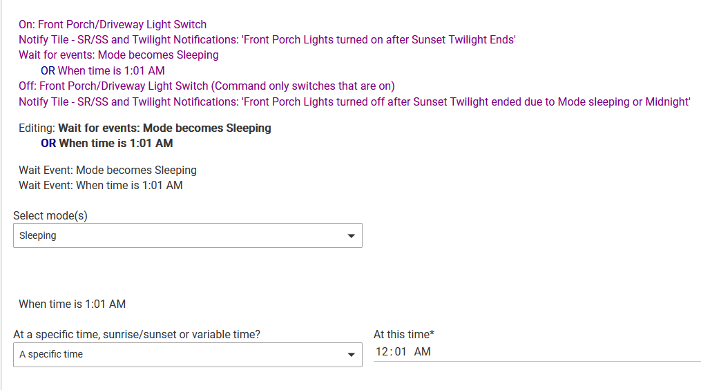

I use rules to manage porch light. I have a rule that was set to turn off the porch at 12:01am OR if I went to bed.
This AM, HE updated the date/time correctly - however. a setting on the time stamp changed itself without me interacting for the value of 12:01
This is a virgin snap, I did NOT touch this rule - just looked at it. As you see, the 'OR' is now 1:01am but the rule details below it say 'at this time 12:01am'. I will be hand adjusting this today but be aware.
edit ** I can't fix it. HE wont let me put the time to 12:01a
