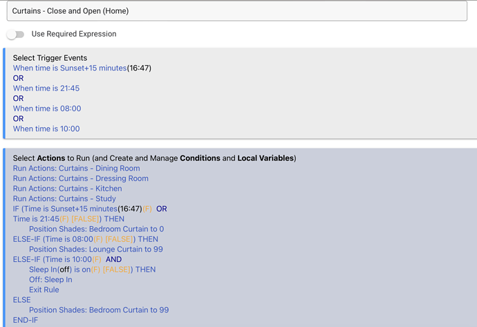

While my hub time changed correctly, the following rule triggered and opened the bedroom curtain at 7:00AM:
