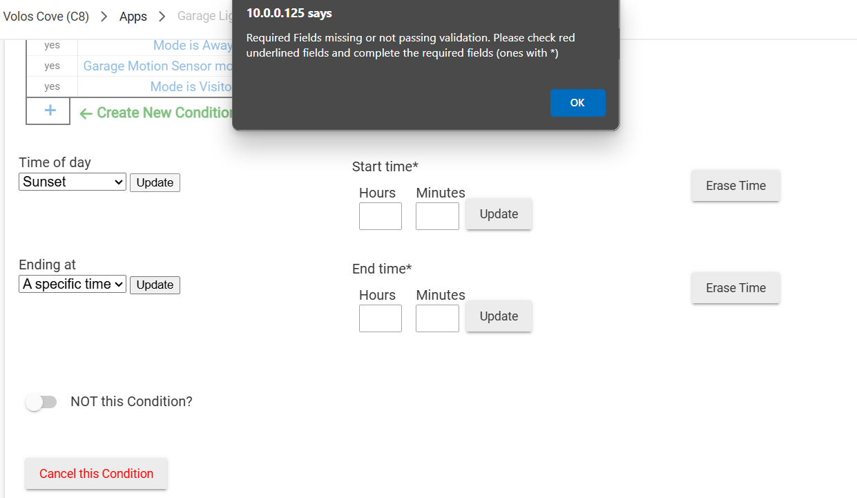

Hello ... getting this error whenever trying to set a time condition.
Never had a similar problem before, any ideas?
C8 latest build.

It looks like you chose a "time between" condition and you have not filled in the end time. Did you mean to use time of day instead of time between?
The above is quite likely the cause of the specific error in your case.
That being said, you also have screen reader mode turned on. If you're using a screen with a keyboard and mouse, consider disabling this option in Settings, and the interface will look a bit less awkward (you might need to hit Update after making changes in your case; I'm not sure the Start time should be visible since you already made a selection) -- though if everything looks right after making the desired selections, screen reader mode or not, that would be a problem. But from the screenshot, that isn't the problem here, at least not with the specific selections made in it.
