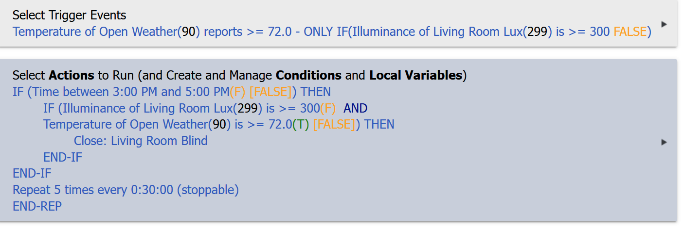

I have tried a few different things. This is the latest. I want to close a blind if it's between 3:00 and 5:00 pm, the temperature is about 72° and the LUX measurement is above 300 lux. It works AT 3:00 but not after?
Enable all logging for the rule (if you disabled it; it's on by default), then look at the output of Logs, filtered to just this rule (or perhaps this rule plus other device events that seem relevant), or share them here for clues.
That being said, I'd also think through what you really want to happen, since your current explanation leaves some room for interpretation, and Rule Machine is a robot that can't think like a human, so you'll need to be equally precise there. :slight_smile: For example, do you want anything to happen at exactly 3 PM (or 5 PM) if your conditions are (or aren't) met, or just the first time they become true after that?
You can also eliminate some duplication: you don't need to check illuminance in your actions since your conditional trigger is already doing that (i.e., that IF would never be reached if lux weren't already >= 300 in the first place). Same with temperature; that's already your sole trigger event, so no need to check the state that would have resulted from the only event that could have possibly caused the actions to run (unless you are doing this from another rule manually, etc. and do need to have it there, not apparent from your description). Neither would cause your problem as far as I can see, but logs will be more illuminating for sure, and they'll make the rule simpler to look at. (You're also missing an END-IF, which again won't cause problems in this case but is a good habit to get into for where it might.)

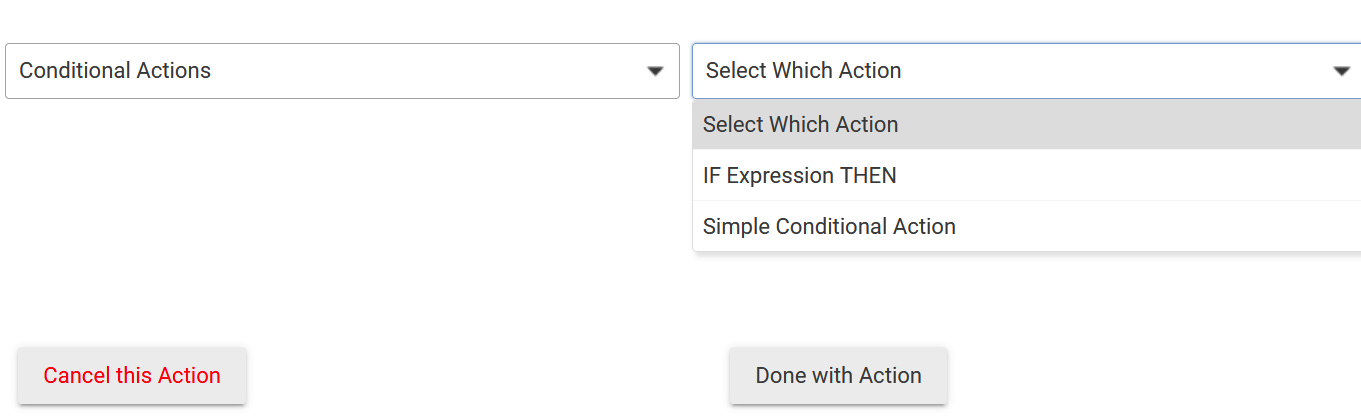

One issue I have is I can't seem to find an "end-if" statement.
This was easier with RPG IV! lol It took me a while to even find the end-if. I have to click end rep first before the end if came up. I am trying to close the blind if at any time between 3-5 pm, the temperature is above 72° AND the LUX goes above 300. The LUX may only go up at say 4:00 PM. Is this better? I have to wait to see the log now. I try to keep logs off unless it's a new routine and I totally spaced even thinking about the log! lol

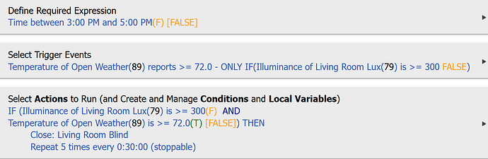

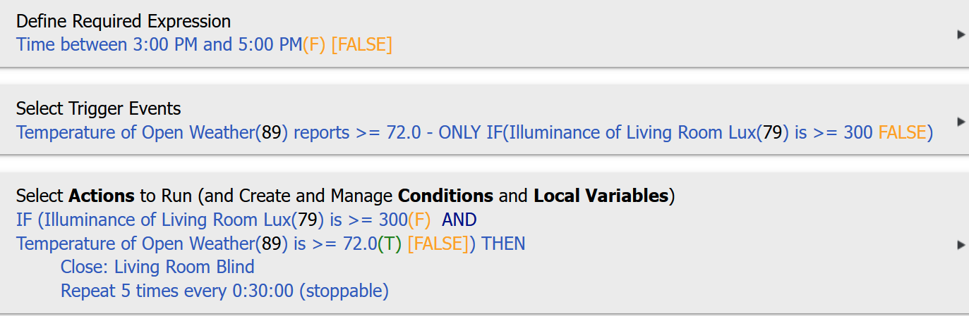

So, the issue I see here is that you don't have anything in your repeat block.
It looks like you want to start checking at 3PM to see if your illuminance is >=300 AND the reported temperature is >= 72. If so, you want the blinds to close. You also want to repeat the check every 30 minutes.

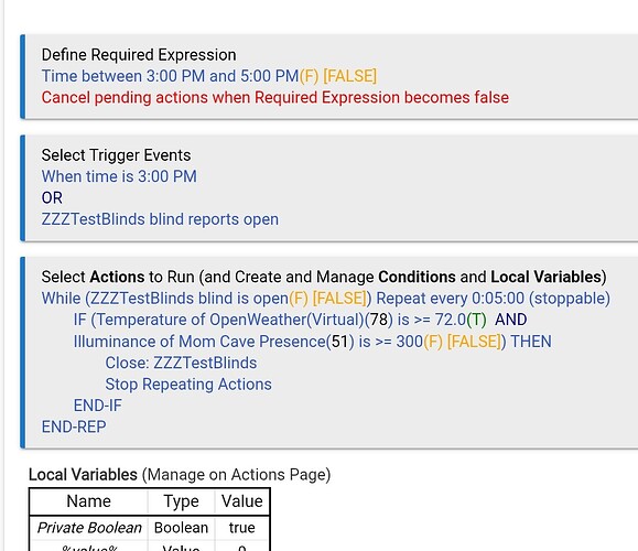

If it were me, I would tackle this a completely different way.
I would keep the Between 3 and 5 PM as a required expression, and select the option to cancel pending actions when the condition becomes false.
Then, I would trigger at 3 PM OR if the blinds open and immediately start your repeat block. I would choose repeat while blinds are open (I put in 5 minutes, but you can use any time length you would like)
The first action would be your current IF statement, then close the blinds and stop repeating actions if true.
If the blinds get closed, it exits. Otherwise, it checks again until the condition is true or the required expression becomes false.
If the blinds are opened again in the same window, it will trigger and start the same loop. If the blinds are already closed, it exits on the first loop.
click to see what this would look like

Every 30 Minutes "WHILE THE BLINDS ARE OPEN"
it triggers once at 3 PM.
Then, it exits if the blinds are closed to begin with OR if the repeats close them.
It also triggers again if the blinds are opened again in the 3-5PM time frame. This allows it to restart if the blinds are subsequently open.
So, mine doesn't run but once, unless the blinds are open and doesn't require a conditional expression that includes devices you are intending to change the state of.
