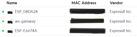

I've got three (assumed IoT) devices on my Wi-Fi network I'm trying to ID...any suggestions appreciated. Did some Googling but didn't find any helpful wisdom. Espressif is in Shanghai...

The numbers after "_" is a part of MAC Address (last 3 hex numbers, sometime in reverse). This may help. Otherwise ping each one and power off one by one.
Ws-gateway is your ecowitt hub.

Thanks! One mystery solved!
Thanks, but I don't have any Kasa devices... I have some Tapo plugs but those were identified properly.

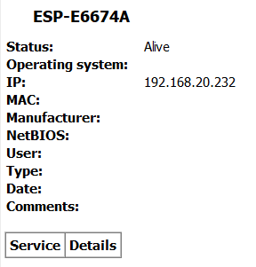

Two remaining mysteries. MAC addresses' three leading pairs only point to Espressif...
e8:db:84
dc:4f:22
Download advanced port scanner. It will tell you what ports are available and possibly identify the manufacturer.

good old nmap -sV [ip] (-p- if necessary) might provide clues.
Yeah I used nmap to ID a device once, I still have my script saved on my router. I used:
nmap -v -sS -sU -A [IP]
The -v gives you extra verbose output.
