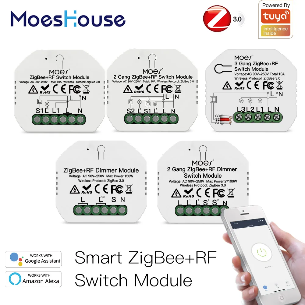

@mcdull Does this look like the one you use (2-gang version)?
I thought about something like this as well, but I wasn't sure I wanted to go this route. Honestly, I'm a bit leery about hooking line-voltage power up to a $13 chinese switch module. If I do go this route, do you really need the 2 switch version? With only a single switch input (the motion sensor) and a single output circuit (the lights), it seems like the single switch version would work fine. Or is the second circuit output used to "decouple" the switch input from the relay output?
Yes, that's the one I use ($26 for 2 from another seller when there was site-wide sale)
It's not easy to pair to HE by the way, the instruction is pretty bad.
I've also used a little smaller Z-Wave+ one from TKBHome but they don't sell US frequency anymore and cost more.
Single switch version will do if you want the motion sensor always turns on the light or if smart bulbs to be used. I use dual switch because that's what I only have. I also use the motion sensor notification during daytime without turning on the light, so I have them on different switches.
