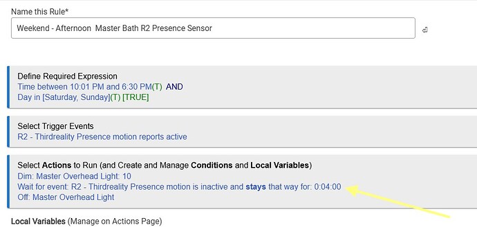

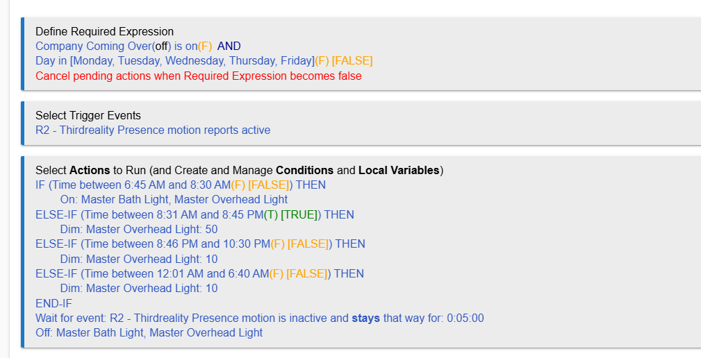

The rule in the doc above is for the weekend: 4 minutes
Weekdays: 5 minutes
Both turn off while we are in the bathroom. Just wondering why it keeps turning off?

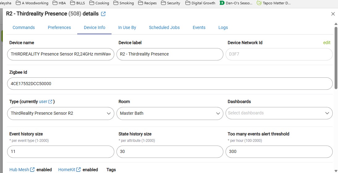

Event history size* per event type (1-2000)
State history size* per attribute (1-2000)
Too many events alert threshold* per hour (100-2000 )
Hub Mesh enabled
HomeKit enabled
Tags
Custom icon
Device note
Device Details
Create Time 12/16/2025 7:57:45 am
Last Update Time 7/07/2026 5:19:18 pm
Last Activity At 7/12/2026 3:15:32 pm
Controller Type ZGB
Device Data
Show raw names
Application 46
Endpoint Id 01
Manufacturer _TZ3218_awarhusb
Model TS0225
I would check the device events. if the device reports motion is inactive then it sounds like the rule is behaving exactly how you set it up.
While you are in the device events you should also check if it reports presence. For your use case with this device, presence could be better for turning the light off.
Unless there’s been a fundamental change to how this particular driver works, this mmW device (like all others) will report "motion” (not presence). AFAIK, the “presence” attribute is still exclusively reserved for home-vs-away sort of stuff (on most/all smarthome platforms, not just Hubitat).
For OP, I’d check to make sure the device is on its latest available firmware, and then re-verify that all available device-level parameters are set as desired.
